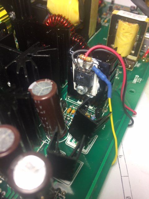

One of the next things I wanted to solve was being able to completely turn off my tubes (no filament) when the projector is also turned off. BINGO!
The attached image shows the top of the board showing where I put a FET transistor (isolated) that I used to switch the 24 volt supply to the 6.3 volt filament regulator. In this mod, I'm only adding the FET (IRF520) and two resistors (12K / 2.2K). I put the supply back together checking it out but forgot to take a picture of the bottom...I'll do that later.
This was important to me to not leave filament voltage on the tubes at all times. When the set is "OFF" the voltage is around 3.9 VDC - when the projector is powered up, the voltage is full 6.3 - this mod also eliminates the 3.9 VDC, by removing one lead of a resistor. But with the switch connected where it is, that resistor should not be necessary to remove.

I guess the 12k is the pull up resistor between the gate and the 24V. If so by putting a 100uF capacitor between the gate-source the turn on would be gradual for the MOSFET, given by time constant of R*C, with 12k and 100uF this is 1.2s
I saw this and tried it. Brilliant and makes perfect sense. But not knowing much about these FET's I couldn'y imagine getting the same results as a regular transistor. I went with the FET thinking it would be better for current.
After putting the 100uf across the 12K, there is still a quick 6.3. So I'm thinking to increase the value of the FET drive resistor from 2.2 to maybe 5K - what you think??

You could use 12k for both resistor, let's see how that goes.
Posted: Wed Sep 13, 2017 6:55 pm    Post subject:
The 12K - 12K combination is PERFECT, when it comes to start (zero), rise (good ramp up), but the voltage maxes at 5.6vdc
Posted: Wed Sep 13, 2017 7:07 pm    Post subject:
Oh yes, you are using on the positive side... remove the resistor from the gate-source and put a 12-15V zener instead. So 12k from +24V to fet's gate, the 100uF cap between gate-source and the zener parallel with this cap.
Got it. I'll have to leave out for about an hour, but this will be done right after that.
Man, I really like how it slowly raise the filament, and it does it all before and within the high voltage turn on..Very Happy
Posted: Wed Sep 13, 2017 9:09 pm    Post subject:
I tried the zener (12) across S - G), cathode to gate. Still quick on..Sad
Posted: Wed Sep 13, 2017 9:21 pm    Post subject:
Strange... anyway you can try your original resistors as well (2.2k and 12k) but then you'd need 470uF between the G-S. We should have started with this...

OK, I go and make those changes. I was also thinking about increasing the capacitance. I'm also wondering about that FET and should I try a T0-220 transistor instead. But first things first..

The way i have it now, I'm trying to put the transistor before the 6.3 regulator. I'm now thinking if it would make sense to put it after the 6.3 out from the regulator, in hopes of it ramping from zero to 6.3 for the filaments. What you think?
Posted: Thu Sep 14, 2017 3:35 pm    Post subject:
Oh, I see. If it is that way probably the best to have your original resistors plus 470uF accross the 12k.

Putting the FET on the output side of the regulator turned out to be the best solution here.
I now have it working to my expectations, but there is a loss as you indicated after the FET stage, and that makes the voltage on the tubes 6.28 instead of 6.3 I figured I'd live with the very slight loss, and still think it puts the filament voltage within the tubes range.
After moving the in/out of the FET stage from the input of the regulator to the output of the regulator, I had to change the resistor values to 6.8K Gate Drive and 10K D/S. And the capacitor (D/S) is the 470 you recommended.
I can adjust the delay rate or rise timing by changing the value of the Gate Drive. Don't really understand why they didn't add a suppressor diode to protect the tubes from seeing anything over 7vdc..Confused
Anyway I'm pleased with the changes. The primary goal was to get away from the 3.9 constant to 6.3 turn-on, and after removing the 3.9 volt option, then the other problem of eliminating that filament flash that the tubes would exhibit when you turn on the set and 6.3 is immediately applied. This is where the added circuit really does what it's supposed to do.

If you want to raise the filament voltage (in order get the proper voltage after the FET), you may want to lower the value of the resistor 4R2 by adding another resistor parallel to it, in the range of 100kOhm, the proper value needs to be experimented of course...
