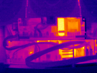

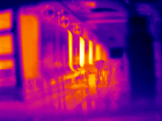

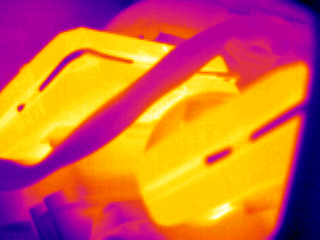

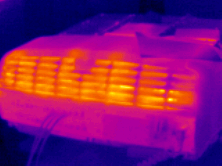

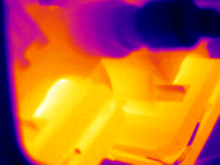

Posted: Tue Mar 27, 2018 2:43 pm    Post subject: Airflow & heat on a G90
I made some thermal measurements on my G90, stil sitting on a bench.
I used
- an air velocity sensor (thermal wire type) with incorporated temperature sensor
- an infrared camera
At startup I measured (SI units):
Front: 0,2-0,3 m/s @ 24°C
Back: 1,5-2,0 m/s @ 24°C
After 90 minutes watching a movie I measured:
Front: 0,2-0,3 m/s @ 26°C (the room has heated up a bit)
Back: 1,8-2,3 m/s @ 35-40°C (most heat on left side, most speed around Stdby-Indicator)
Looking in the service manual I noticed the front fan is NOT temperature controlled like the other 4 fans. Its always running at nominal speed.
I took some thermal pics of front electronics after unscrewing the front shield. Although the airflow is not very strong (0,3m/s max) there is nothing inside going much beyond 50°C (bright yellow).
I guess the fan blows into the main housing, where the airflow is going towards the large fans and expelled through the backside. I find it strange the front-fan is doing so little in terms of air velocity. I wonder why the pressure generated by the main fans wouldn't suffice to suck in the same amount of air from the front? Or is the air from the front-fan going somewhere else?

The back, obviously.

peeking through the left hole in the plastic cover on the front side.

peeking through the right hole on the front side.

The radiator on the lower board, from the side where the components are bolted on.

The frontside, with the cover off.
