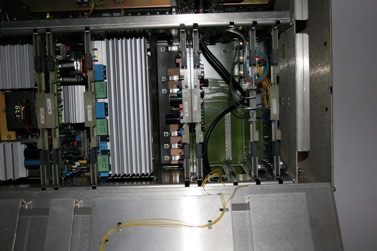

Hi Guys,
Here is a picture of the 919 video plumbing. Semi ridged coax and SMP connectors fitted to the back of the board. Also have done the neck boards with rigid coax

which input board are you using?
gregstv
Joined: 27 Aug 2007
Posts: 628
Posted: Thu Jul 27, 2017 10:54 am    Post subject:
Moome 1.4 internal.
