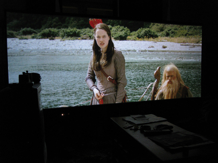

Hi!
I managed to push my G70 to do 1920 x 816p at 72hz and it works like a dream.
If one do this with a G90 what will be the limit? Lets say you get halfway to 4k at scoop. That would look amazing!
Can one force the netflix stream to do 72hz via Powerstrip? Any thaugths? Cheers!

Posted: Tue Jun 20, 2017 1:51 am    Post subject:
beautiful screen capture BTW,
4K definitely not possible,
downscale to 2K, maybe?
