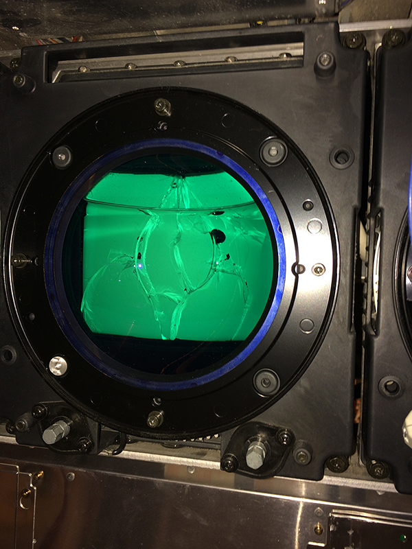

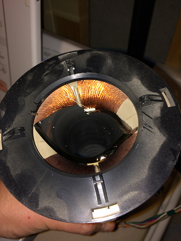

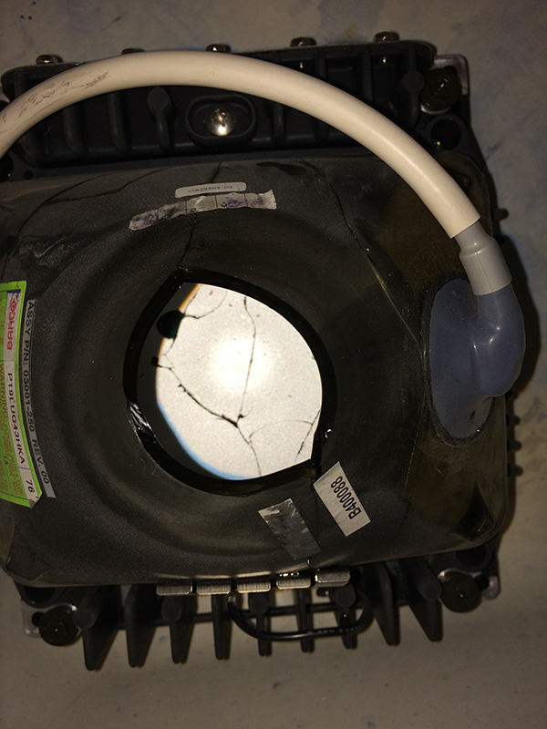

Hey all,
I installed this green tube about a year ago, and probably put 100 hours on it since. Two nights ago, we heard a pop and the projector powered down. I got overly optimistic and checked the blue and red first. Nope. Of course it was the green. I was wondering if anyone had any insight in to why this might have happened. Dare I put in another tube without checking some things?
Coolant was full and the bellows wren't distended. Tube was used when I put in, maybe an 8 or so, but the wear pattern only covered a sliver of the side of the screen.
Projector is dead center and maybe 10 inches further than the recommended distance for my screen size, so the raster might have been just a bit small, definitely not hanging over the edge of the tube (unless I missed something). No other indication of trouble at all.
We had used the projector for a couple of hours earlier in the day, then it was off for maybe two hours, then I turned it back on and it had been running for maybe 15 minutes when it popped.
Also, I'd love to hear any thoughts as to whom or what I need sacrifice or atone to stop having my green tubes always taking the fall when I have a shelf full of minty fresh reds and blues.

This can happen. It happened.. twice.. to the same customer, with new tubes supplied by me. Go figure. The third tube has lasted, but it was frustrating to say the least. Never did figure out why two tubes died.
A few things:
1) Is the Dallas chip new?
2) Has the set ever given a 67 error code that you ignored and kept using the set?
3) Did you install the replacement CRT into the Sony housing? If so, did you put the 4 spacers between the frame and the tube?

I got the set with a badly burned green in it and swapped it for my precious spare green with no visible wear... which developed a heater-cathode short after about 100 hours. Replaced that with this one, got maybe another 100 hours. I got the first spare out of a 1209 a local guy was parting out. This second one I got from you, but it was slightly worn, and I think I barely paid shipping for it, so I'd consider us more than square on it.
I realized when this tube popped and I briefly considered caving and getting a digital, that it has been 22 years since I have been without a CRT projector that I was either using or nursing back to health.
~ Dallas chip: Got one from you last year and replaced it before I ever powered this thing up!
~ 67 Error: I don't think so, though there is a slim chance I just never noticed it. Would I have had to do something to clear it and keep using the set, or could it have been warning me for weeks and I never looked at the back of it?
~ I did the installation, just cut the old one out, cleaned up, and glued the new one in. Was careful to get all those little mushroom shaped pins back in place.

I have G90 spare tubes potted, tested, and ready to ship ALL the time.
The first G90 I ever got came with a busted blue tube.
I truly do not understand why G90s tend to pop tubes when no other projector does that, unless they're dropped several feet
while still in the crate. (Which Curt knows about, having had that happen to one he bought once!)
I actually find myself wondering if the smaller heatsinked area of the G90 tube frame, as compared to the heatsink area of other
tube hardware, might not be a factor. It may be that the G90 tube runs hotter because of it.
In general I do recommend that G90 owners would do themselves a favor by taking the contrast down a few points. It keeps the tube cooler, improves tube life, and you'll soon get used to the slight reduction in brightness.

Like I said in the other thread, Curt has seen this at least twice in G90s. It's happened in one of my own units once. And now there's this one. That's four known cases not counting what anyone else may have seen.
I'll bet Craig Rounds has seen it!
I think that G90s get run harder than any other projector because their focus magnetics are so good that you can run the tubes
really hard and still get great sharpness. But the harder you run the tubes, the hotter they run.
And the G90's tube frame with heatsink has LESS heatsink area than any other LC tube assembly I'm familiar with, and I'm familiar with them ALL. I've replaced tubes in every kind of LC hardware you've ever seen and several you have not. EIS, Barco 04045, Skylight I, Skylight II, Suprapan, ESCP 2000, AMC, Barco MRP, 909, G90, Marquee, you name it. Of all of them, the G90 frame has the smallest effective heatsink area and that's in a projector that is most likely to run tubes hotter than any other.
I also have the tube spec documents from the manufacturer. They define the cooling requirements among other things.
It is possible to run a tube at a temperature above 200 degrees on the faceplate. But tube life will be short!

All brands of sets have done it, the worst were the old analog Barco 9" sets that turned on the 34Kv without ramping it up slowly as later Barcos did. That killed more tubes by cracking than anything.
It sounds like you installed the replacement tubes correctly. The error 67 would shut the set down. NECs tend to have a V chip fail, where the raster shoots way off the tube, and the electron beam hits the bell of the tube, right at the yoke, overheats and snaps it. I don't think Sonys do that. The bad thing about the NECs is that when the V shift goes way off screen, it does not come up with an error message. A poor design for sure.
I don't have any other explanations for you, sorry!

I recommend setting the contrast no higher than you need to really enjoy the picture. Only way to find out is to experiment.
But a contrast level of 80 or more is, at least to my eye, excessive. That trades tube life for a brighter picture.
Your green tube has obviously been replaced before. With one originally provided by Barco, so sayeth the label.
Barco must have bought tens of thousands of tubes from Panasonic for their refurb business. I still regularly encounter Barco overlabelled tubes made by Panasonic before Panasonic changed their label design.
