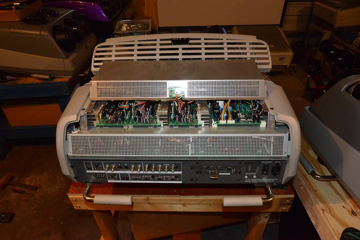

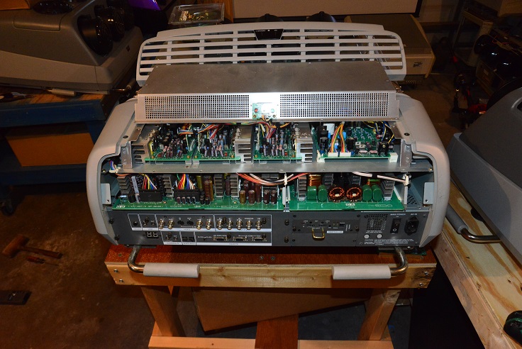

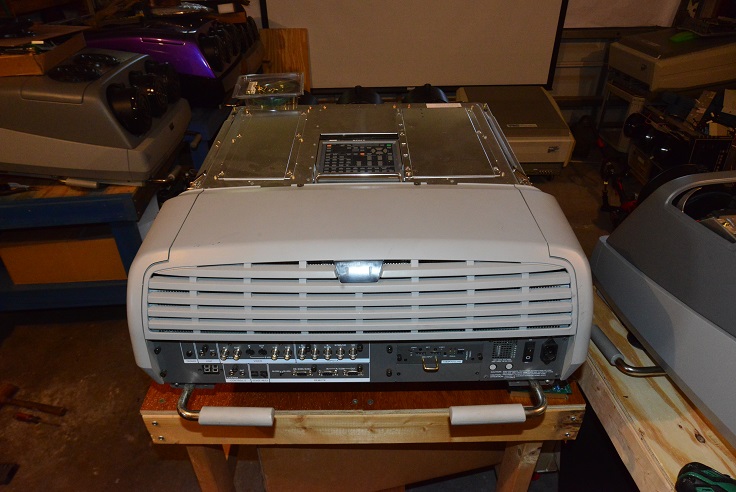

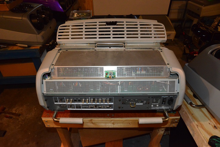

Pics: You're looking for the GA and GB boards.
These four pics are step-by-step to get access to them.
Remove the top cover.
Remove the rear plastic cover by releasing the 2 black captive screws. No need to completely remove the screws, just loosen them until they are free of the metal underneath.
Remove the 11 screws that attaches the upper shield that is now exposed. Remove the shield
Remove the six screws that attach the power supply bay vented shield. Note that two screws are different from the others, they
are longer and black. Note where they go, they have to go back to their original locations.
Remove the shield, and the GA and GB boards slide out, you have to remove the connectors as you go.
