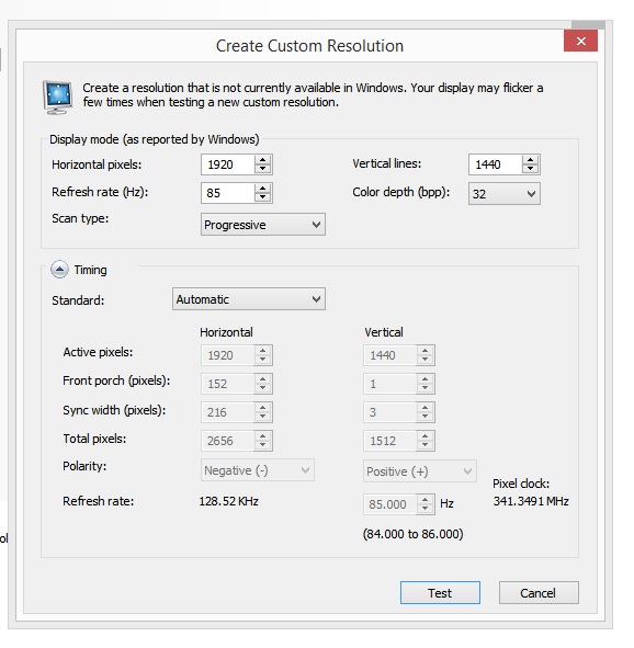

I was searching for that with no success Sad However i found "sync. on composite" which doesn not affect image at all.
EDIT:
Found this in PowerStrip and immediately changed from + to -
However effect is still the same Sad The image JUST won't show up. I'd like to add normal PAL or NTSC resolution to test it, but then i have to unplug the cable aaaaand plug in the projector, but then, I guess PowerStrip is aborting new setting.
At least i think so because the effect is all the time the same >Sad.

I see that you have "composite sync" checked under the Synchronization tab. Uncheck that and see what it does? RGBHV does not use composite sync. It probably won't have any affect though because I think that may just enable composite sync if you have the option. Who knows...
Also - Powerstrip is a 3rd party application and may not always be guaranteed to actually affect the parameters your trying to affect. What kind of graphics card do you have? Here's a screen shot of Nvidia's control panel:
