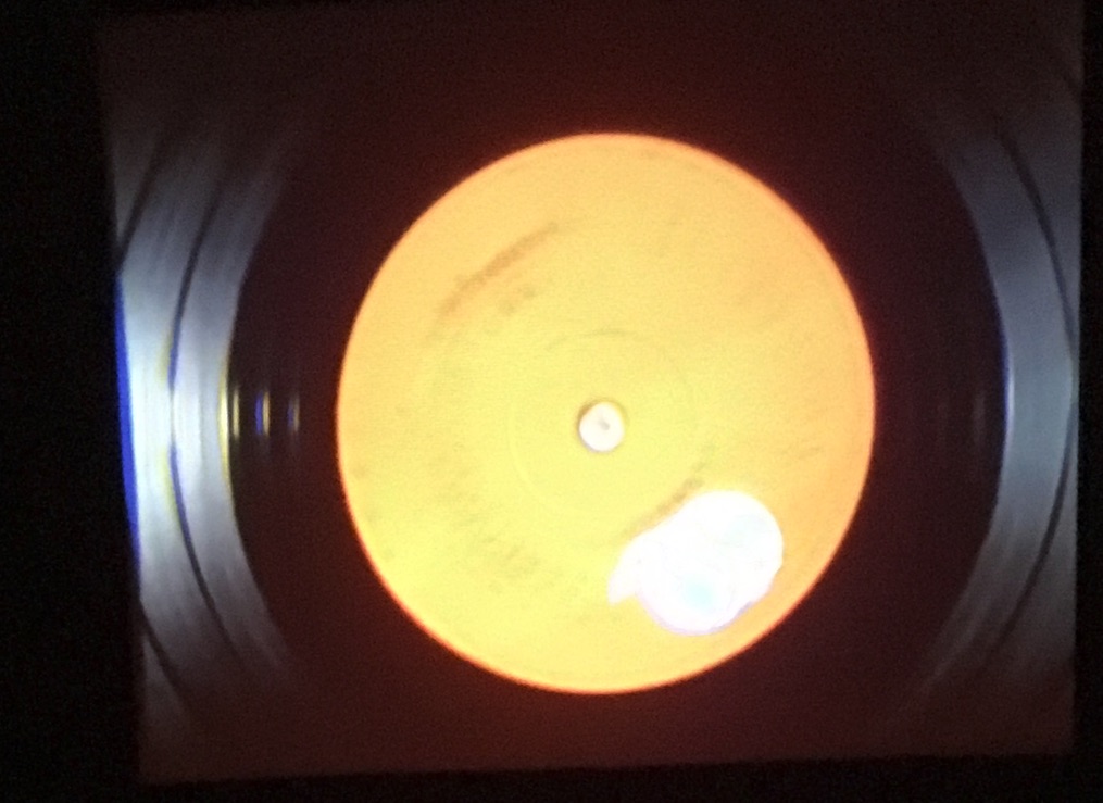

Hi Wonder if anyone can help me out,
I've got a Blue issue, on the left side centre of the screen,
its bent out of the picture,
See image
[img][/img]
Not sure how to fix it?
Looks like it could be a magnetic bend,?? as I can't fit it with any of the controls on the projector.
any advice would be greatly apricated,
Jim

Posted: Mon May 15, 2017 1:19 pm    Post subject:
You can converge that out BUT G70s often develop problems with their convergence boards so that is probably the real issue you need to address.

Posted: Tue May 16, 2017 2:40 pm    Post subject:
I have got another G70, that I got for spares, Do you think I would be able to swap out the Convergence board?
is it something that I could do?
can anyone help me on where to find instructions on how to do this
thanks
Jim
Posted: Tue May 16, 2017 4:44 pm    Post subject:
Yes. It just plugs in. Not much harder than changing a light bulb.
Posted: Tue May 16, 2017 8:38 pm    Post subject:
it's one of the big vertically oriented boards, pulls straight up and out not unlike a PCI card in a computer
http://www.curtpalme.com/SonyG70_Layout4.shtm
Posted: Tue May 16, 2017 9:07 pm    Post subject:
Check the main site, it's got the location shown in the tips/FAQ section.

Posted: Wed May 17, 2017 3:00 pm    Post subject:
It also looks to me like your red is a little out of covergence too - or is the image supposed to look like that?

Posted: Thu May 25, 2017 12:37 pm    Post subject:
Hi
After resetting every setting I could find,
looks like it corrected the issues,
thanks
