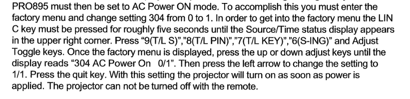

I have a Zenith Pro895x that I bought new and years ago I set it up to turn
on when my system turned on with a series of button pushes. I am selling my
house and projector stays in theater but I can't find info to reset
projector to turn on with the remote control. Any help would be appreciated,

No, sorry already went through manual. I am trying to go back to the default internal setting where projector turns on from remote, not when power is applied.

I asked him to post here. There is apparently a hidden menu where you can do that, but I don't know of it. You can do the same with the popular data projectors, so that when you flick a light switch in a classroom (for example) the projector comes on. I don't know how to get into that hidden menu.

Posted: Fri Apr 21, 2017 2:18 pm    Post subject:
All projectors have this feature.
Here is your answer wttw:
