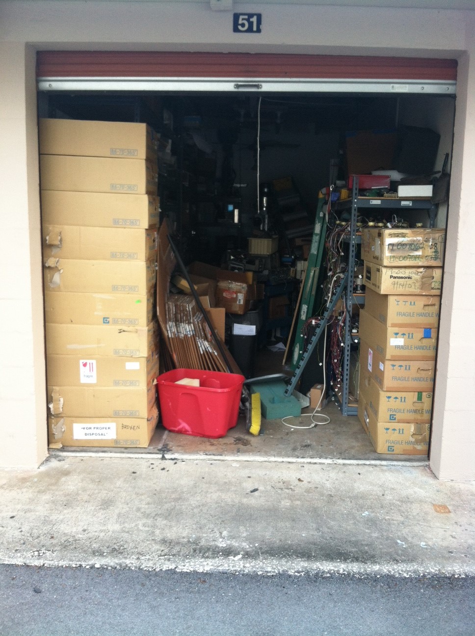

Well, the boxes on both sides of this storage unit contain (up to) six tubes per box.
But to be quite honest about it, a lot of these tubes are not good enough to sell as good.
I am extremely picky about what goes into a projector. My basic requirement is that the tube must be
virtually in new condition. That means zero visible wear or defects in a 16:9 maximized raster area.
I have some B stock tubes that MAY bring a little bit of money. If you can tolerate ONE small defect in an
otherwise perfect tube, I can offer incredible deals on some tubes like that.
But most of them will be heading to the recycler over time. People just don't want tubes that have very, very light wear
if the edges of that wear cross over the edges of the active raster area and that is exactly the case with a lot of these.
To give an idea, I have about a dozen brand new PT-22 green LCPs with P43 fast phosphor on the right side, along with I think
it's eight 8" P43 fast phosphor tubes as well. (Green) I know that I have not less than 18 perfect red LUGs in here. I have,
I think, not less than six each blue and green new condition LUGs, not counting those mounted in Marquee hardware.
I'm sure that between these and the tubes in my projectors I have over a hundred CRTs. I will get more over time but will
also weed out the less than excellent ones so I expect the total to shrink a bit.
Aside from two recent projector additions to my ever-growing overstock of projectors, every projector features zero visible wear
or brand new condition tubes.
I'll change out a tube for ANY visible wear.
