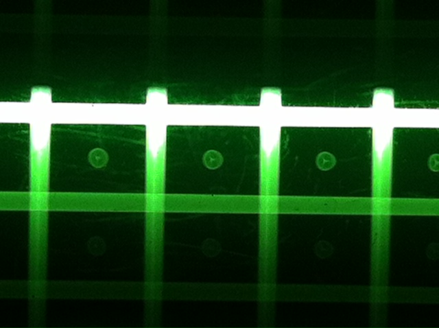

For those of you who still do such things, here's something for you to look at.
You no doubt remember Bill Blue's guide to setting up Marquee magnetics, as well as Guy Kuo's Holy Focus guide.
I've been doing magnetic setups on literally dozens of Marquee CRT assemblies over the past few weeks, and every assembly has included 2/4/6 pole CPC ring sets.
I've learned a neat trick to ensure perfection in the setup of the CPC rings.
It's as simple as this: Do your final adjustments at MAX CONTRAST.
By doing this, this brings out details in the big round dot at high focus levels (Go straight to 100 focus for this) and
those details in the dots are the final arbiter of the quality of the CPC ring setup.
This only works if your CPC rings have the 6 pole triangularity adjusters.
What you're looking for is a triangular feature INSIDE the out of focus dot. And that triangular feature should be symmetrical and well centered in the dot. It only appears at high contrast levels.
Here's an example of this done perfectly.
Sorry about the scratches, they're on the lens used for testing the assemblies and there's no point in replacing the lens.

Posted: Tue Feb 21, 2017 11:52 am    Post subject:
Oh, I would also mention that sometimes you can NOT get both perfect raster centering AND perfect magnetic alignment of the focus yoke at the same time. This is because there are eight individual magnets in the focus yoke and if they are not all well matched in their magnetic properties, it will skew the alignment of the magnetic field. This is a deficiency in the design of the focus yoke, and the way to correct it is to send the yokes back to VDC to be recalibrated in their focus yoke calibration fixture.
If you can't get the raster centered up well with good flare with the CPC rings in the neutral positions, your focus yoke has this problem.

Not sure what is the big trick here, I don't know if this is actually written down in the advanced procedures section, but am 100% sure this have been discussed many times in the forums.

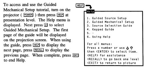

Posted: Tue Feb 21, 2017 1:37 pm    Post subject: Re: What perfect CPC alignment looks like
gjaky wrote:
BTW, Too bad Electrohome engineers did not put proper raster centering facility in to the Marquee, it is a real PITA how it works.
BTW, the Marquee has raster centering. Bad thing is that it's not part of the geometry controls. It's buried in the help menu and there in the guided mechanical setup...

Posted: Wed Feb 22, 2017 12:32 am    Post subject:
I haven't previously seen the part about looking for the triangular feature inside the defocused blob at high contrast levels.
If it was there I don't remember seeing it.
I've found focus yokes that were so out of adjustment that they were rejected as unusuable. That's unique to the Thomson yokes
used on Marquees. All the other types seem to never have this problem.

Posted: Wed Feb 22, 2017 10:25 am    Post subject:
I’ve checked on my test Marquee, it indeed have raster centering, as Barclay said, but there is no scale of the control, so how do you know where it is? I mean, if you perform the CPC-Focus centering method how do you know if you not counteracting with an electronic adjustment extreme that was left there before?
Anyway, the static raster shift is one of the least stressing electrical adjustment, the vertical deflection circuit does not generate much heat at all, especially in 16:9 aspect ratio. The horizontal deflection currents are in the range of 10-30A, adding ~100mA static current to those coils for centering will not really change the things much there either Smile

Posted: Wed Feb 22, 2017 11:18 am    Post subject:
Correct. The centering mechanism is based on dedicated circuitry which shouldn't interfere with deflection or convergence circuits. Too bad that it doesn't include numeric values for the settings. In my opinion, the horizontal/vertical null point (least influence of the centering circuit) can only be obtained through two possible methods:
- Using the help menu, moving the raster to maximum left/right and up/down position and trying to set the midpoint for each
- Measuring the shift voltages (at C31/C55/C96 on the HDM; not quite sure where to measure on the VDM) and setting those to minimum/midpoint in the menu

Posted: Wed Feb 22, 2017 11:44 am    Post subject:
As it seems on the VDM U4 adds a DC offset to the output amplifiers resulting a vertical centering feature.
