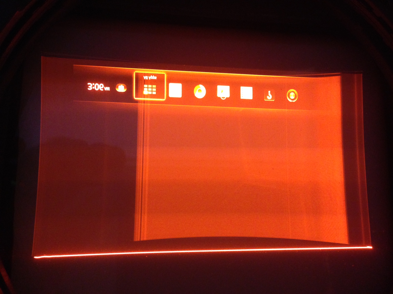

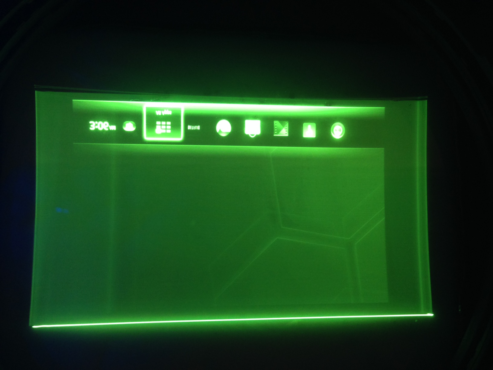

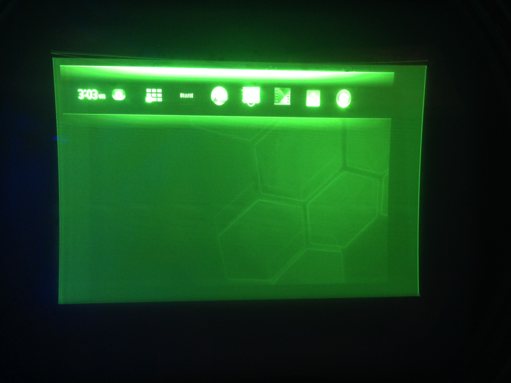

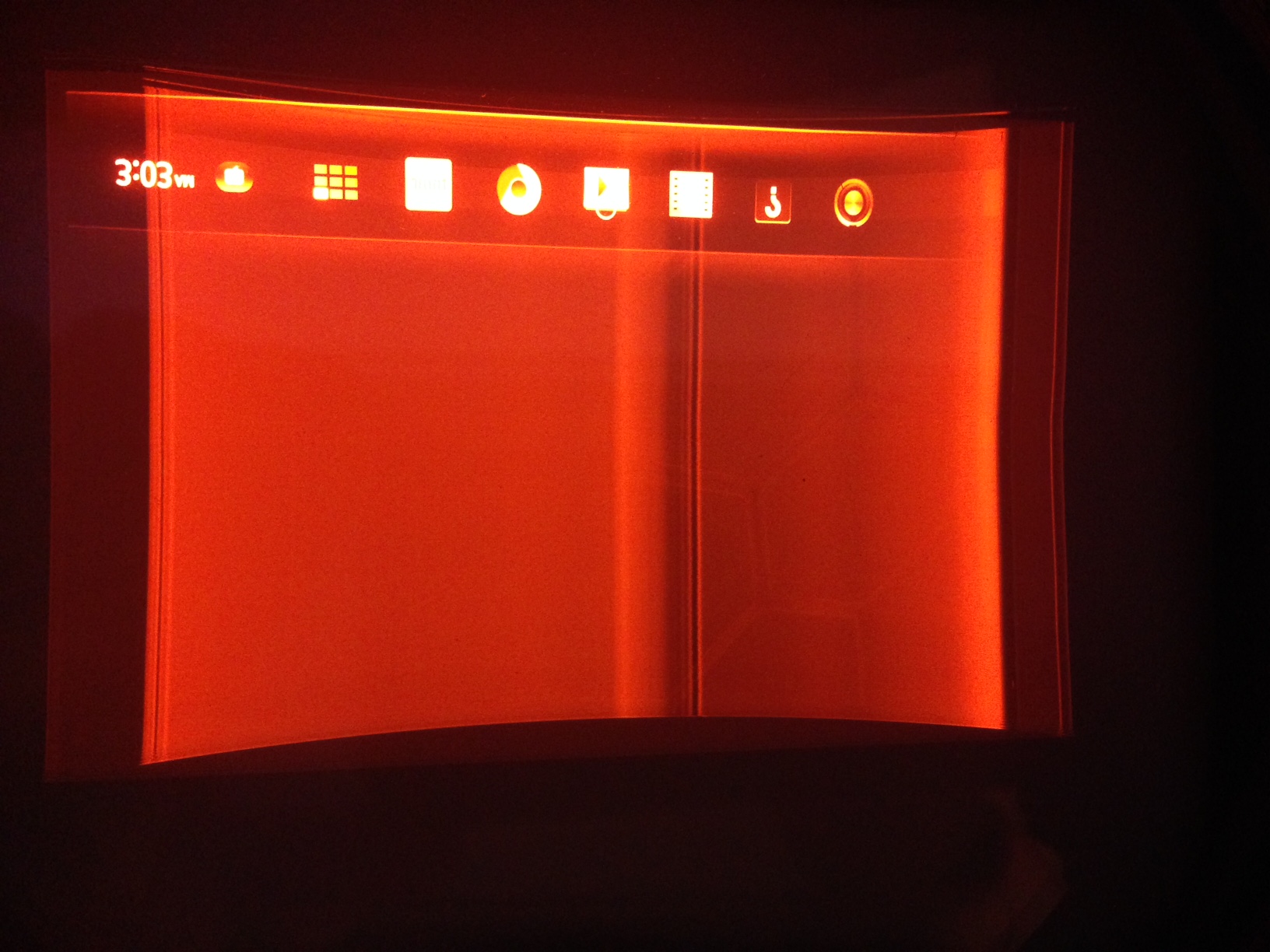

Here are a couple of pictures of the tubes.
Red 720p

Green 720p

Red, 1080i

Green, 1080i

The menubar looks the same on all colours with both resolutions and to me they don't look like cropped. What you have there is a black level clamping problem, mostikely someone touched the internal "do not touch" pots, not all hope is lost yet Smile

Yes, it is the air-cooled model. Would this black-level clamping explain why the intensity of the red tube is not uniform across the face? We can also see the vertical line break in the red.
Posted: Tue Jan 31, 2017 4:31 pm    Post subject:
Sure it would.
Before touching anything get some fine tip permanent marker and sign all potentioneter where they are set at the back cage.
Then locate the R BIAS pot on the GAIN CTL board and try to adjust and see if it has effect on the problem?
