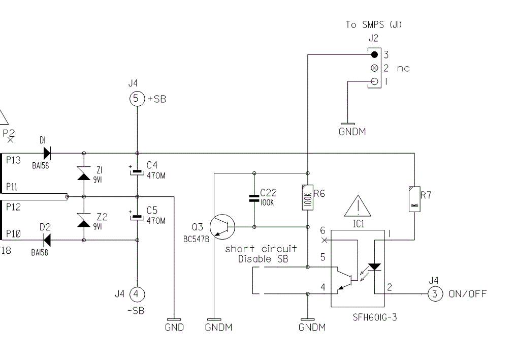

Hmm, fans running means smps is still running to.
Any electronic skills? If not, try replacing smps, then controller. If yes, check the circuit around photocoupler ic1. The smps should shut down if you pull the J2 connector (danger, connection to mains!).
