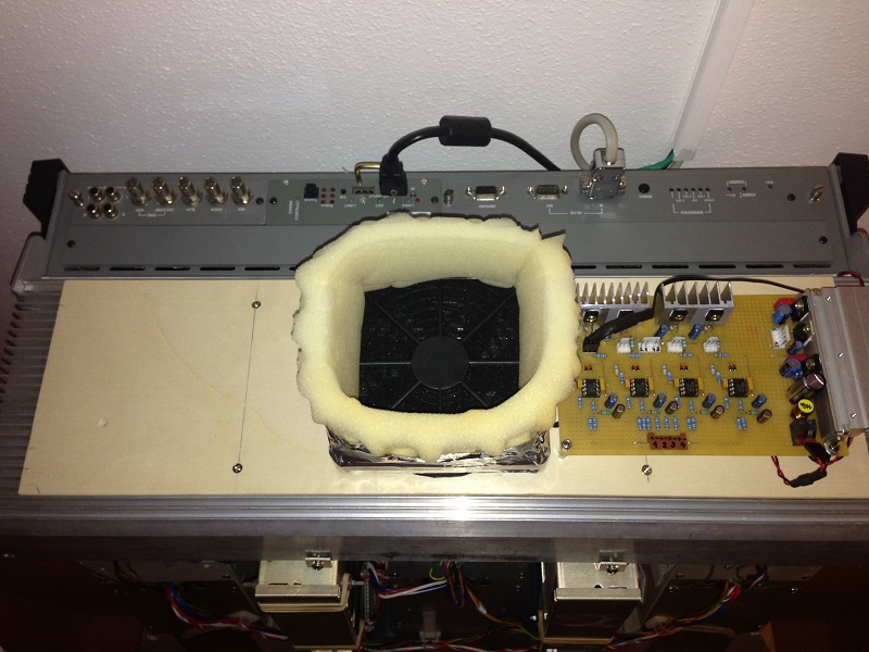

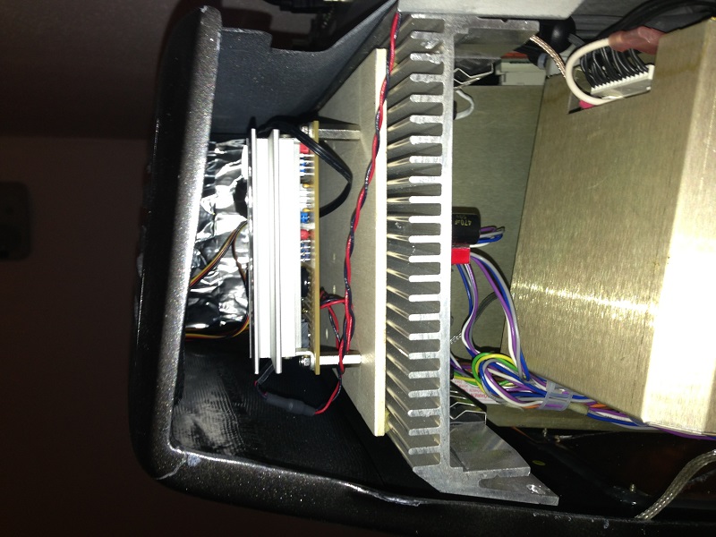

The heat transfer between the transistors and the heat sink is good enough with the insulation strip on a stock machine. This is evident when verifying the heat sinks temperature during operation: It usually gets too hot to touch where the vertical board and the convergence board are mounted. But: This heat isn't dissipated well enough.
If You want a lukewarm heat sink, then You will need to move that heat away from it.
I use a thin piece of wood, bolted to the outside of the heat sink (see pictures). In the middle there's a hole where a 12cm (4.7'') fan will blow against it. The air passes horizontally through the grooves and exits to the sides, taking a large amount of heat with it. The foam (taped to the fan using aluminium tape) forces the fan to suck fresh air form the outside of the cabinet only and prevents any air from the inside being sucked in again.
Convergence and vertical size is very stable now. I only notice a small drift if the room temperature is much lower (~10 degrees) at start up. This drift is lower than 2mm (0.07") on a 114'' screen and disappears after a few minutes.
Regards,
barclay66
P.S.: Please ignore the additional board on the wooden piece. That's my first version of a fan controller which has been replaced since.

ronaldus
Joined: 25 Dec 2010
Posts: 183
Location: france
Posted: Fri Oct 28, 2016 6:40 am    Post subject:
Hi Barclay66,
That looks like an intersesting addition to the heatsink. Is the fan temperature controlled also?
Isn't the marquee cooling sytem designed to blow from the sides of the heatsing towards the middle?
You are blowing from the middle towards the edges. Doesn't this counteract the heat flow?
According to your results no.
Regards
Ron.
barclay66
Joined: 27 Jun 2011
Posts: 1304
Posted: Fri Oct 28, 2016 9:21 am    Post subject:
There are two more or less separate air flows on a stock machine:
- LVPS fans: Sucking through the HVPS and blowing through the LVPS
- Belly fans: Sucking from the base plate into the tube housings and the HDM/FGM cages. From inside the tube housings equally into the neck board cages and the metal tube housings. Only a small fraction of the air flow reaches the component side of the boards on the rear heat sink.
The grooved side of the rear heat sink doesn't get any active cooling. It is supposed to be cooled by convection only. For this, the grooves would ideally be oriented vertically, but that would have required a much more expensive production process (milling instead of extrusion).
On my machine I have reversed the direction of the belly fans. Why? Because my Marquee is hanging on the ceiling. Trying to push heat downwards didn't seem to be the best idea and so I simply tried it and it proved to be a good solution. The air coming from the rear heat sink fan becomes part of the flow that gets sucked to the outside via the belly fans. And I have two additional fans that take care of the HDM and the FGM as their cages wouldn't get enough air flow after the reversal of the belly fans.
All of the fans are temperature controlled:
- Channel 1, Overall temperature -> Belly fans
- Channel 2, Rear heat sink temperature -> Rear heat sink fan
- Channel 3, HDM temperature -> HDM fan
- Channel 4, FGM temperature -> FGM fan
The only fans I left alone are those at the LVPS. I just replaced them with low noise parts that at the same time would ensure the same amount of air flow.
Check on tschaeikaei's fan controller project (http://www.curtpalme.com/forum/viewtopic.php?p=456758). He did something quite similar...
