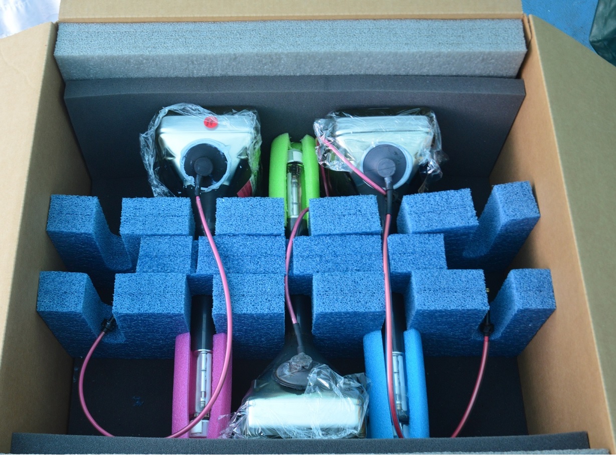

I submit an example of how I pack bare CRTs. Here's a set of three minty LUGs going to a happy G90 owner.
There are FIVE inches of foam padding, at the minimum, around the tubes on all sides in this 24x24x12 box.
The foam is of two durometers. Softer to absorb movement, heavier (the blue and white pieces) to keep the tubes
firmly in their general position. There is space for every tube to move, to a reasonable degree, but they're held
firmly enough that they won't hit the sides of the box easily.
This packing is fully compliant with shipping regulations for ANY carrier. It's insurable.
And it's but one example, incorporating several principles of delicate instrument packing, of how to pack a tube
so that it is monkey-resistant. Which is important when shipping via ANY common carrier.
Do not place GLASS, FRAGILE, or HANDLE WITH CARE labels on a tube shipping box. All that happens when you do
this is that the disgruntled distribution center employee of the day will single out the brightly colored targets on your
package for a little extra treatment.
Better to go stealthy than to alert a box destroyer of an easy target. But not THAT easy, if you pack it right!
Nobody wants to sell a tube and end up hearing from the buyer that it's broken. Nor does any buyer want to get a broken tube.
So do yourself a favor and really THINK about how to pack and ship such things. If you can move it around by hand in the box in ways you don't want to happen, it WILL happen. So pack it FOOLPROOF.
Lots of padding, lots of space. Room to move. You need all of them. Or tubes will break and nobody will be happy.

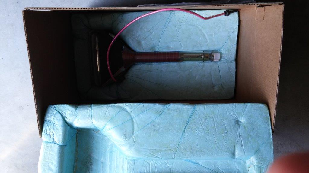

I used to box the tube in foam, then put it in another box with foam wrapped around the inner box. You have to figure that the box will most likely be dropped off the back of a truck or by the person delivering it.

Even when properly supported postal workers still triumph !! Evil or Very Mad
Look closely at the pin end of the neck. You can see a line that runs around the neck. Yes its been decapitated.
You really couldn't pack any better so there is always a risk.

The problem with packing like that is that it holds the tube too firmly in position, which means if you drop the box,
the tube accelerates and decelerates at the same rate as the box. There's no real opportunity for the tube to move
and get a chance to slow down gradually.
For a tube, the IDEAL packing profile is to support the bell end with heavier foam, support the midpoint of the neck with medium
foam, and support the end of the tube with soft foam. This reduces torquing across the tube neck as everything will move about
the same amount in response to impact.
You need the tube to be able to move...SOME...and you need it to move all together without applying stress across the length of the tube.
I take your point about a little give in the packaging. The image is of a factory pscked tube. I have however received tubes more softly packed but the issue here is that this type of packing allows the box to be pierced by another object or crushed under something else. I suppose all i am saying is if you want transport tubes expect broken ones. No-one can protect you from postal workers.
