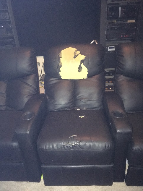

Hey guys, I've never seen this addressed here before. I bought a set of 3 Berkline leather seats from a fellow forum member last year for a song. About 2 months ago, the leather skin started to peel away from the chair, leaving only the backing. What started as a tiny missing bit has now turned into most of the headrest missing, and the seat is starting to do it too. It looks ugly as sin. Evil or Very Mad
I called a leather place today, sent him some pix, and he told me that what I had was a bonded leather seat, that it's only a thin skin of leather on a backing (and he's exactly right, that's what I have), and a typical life span for bonded leather is 2 years. He referred me to a leather upholstery place, and figured I'd be looking at $1000 or so CDN to do it. I love the seats, I've got a set of three, but I'm on the fence as to whether to do it or not.
Does anyone have any other suggestions? It's the middle seat that's worn, and I'm usually the only one using the theater, so the repair/re-upholstery can be slightly different from the other two outside ones, that for now are still fine.
Thanks!

SpankyHam actually does leather repair on high-end furniture. He'll probably have some expert guidance, but here's my take from talking to him about leather stuff a few times...
Yes, that's bonded leather. It isn't just thin leather... It's ground-up leather made into slurry that's laminated onto the fabric backing, then embossed with maybe a layer of polyurethane to protect it. The whole thing is kind of like how paper is made.
I wouldn't repair the chair - certainly not for a grand. That's ridiculous. I would think somebody could put a new matching panel on the headreadest for a few hundred bucks. Regardless, you can buy a brand new real (top grain) leather chair for $600-800 (each).
What you could do is just throw some IKEA black blankets over the backs like I did in my old room. It would just cover up the issue.

I agree with Steve. I would not sink much money into these.
That sort of leather is used on cheaper seats to cut costs which means that there are probably other cost cutting measures done to make those seats hit a certain price point. Redoing them with good/real leather would fix them for now but who knows about the rest of the chair...
I'd put the money towards replacement chairs.

Bonded leather is what you have. "Pleather" is a very inexact term, but basically is vinyl. There are a slew of artificial products, and people generally mix them all up. "Pleather" usually refers to vinyl - plastic leather... "Leatherette", like what's in VW car seats is PVC (vinyl) laminated onto fabric. It's also vinyl... It's just better-looking, better-wearing vinyl than what we had forty or fifty years ago. Alcantara and Ultrasuede are suede-like synthetic fabrics. Everything else is pretty much a variation of those things.

Oh, and bonded leather or pleather isn't better than vinyl per se; it's just different. There are pluses and minuses.
The bonded leather looks and smells like leather (because it is, sort of), and it breathes better and is more comfortable to sit on, but as you've found, it doesn't wear for sh*t. Personally, I wouldn't ever buy a piece of furniture with bonded leather. When you see cheap leather furniture in Walmart, that's what it is. Craigslist and classifieds are littered with used furniture that looks just like your chair that's coming apart. Of course, it's worth nothing because who would buy furniture that looks like that?
Vinyl (or leatherette) is great for cars because it's extremely durable and cleanable. It'll last for years and take abuse, but of course it looks and feels nothing like leather. Good for cars, not so much for furniture.
Top grade leather on the other hand, looks awesome and feels awesome, and if you take care of it, will last for years. I saw an absolutely beautiful sofa in a Goodwill/Salvation Army type store a few months ago. It was a gorgeous modern Danish design, probably from the late-sixties or early-seventies. Looking at the design and build quality, it was obvious it cost a small fortune new. It was disgustingly filthy and had been abused and neglected to the point of no return, but the leather was all completely intact. Amazing.
