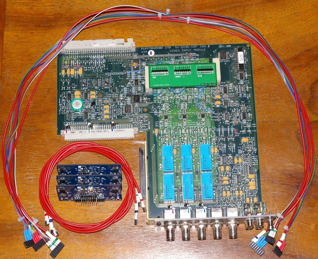

After finishing the XG-VNB project I wanted to utilize the experience I gained with that, in a way that is more usable to the community...
So I made what I already said once:
A daughter board for the Electrohome VNB that completely bypasses the VIM's high frequency part. This alone would not worth to make it, the mod cures the VIM's weakest link: how the OSD signal is injected.
Unlike the original design this board does not use any series switching element in the signal path, still OSD injection and input blanking is carried out, with the least intervention to the input signal, all this with the best possible decoupling between the input signal and the OSD source. No needless amplifiers, and switchers in the signal path, the shortest, cleanest signal path possible.
Each board has an own local +/-5V supply that feeds the whole neckboard too. The most sensitive circuits on the VNB are fed from these supply lines.
For the blue tube a new experimental gamma circuit was also developed, again without adding a series element to the signal path (unlike to the original VIM design), so the signal path is equally "long" on all colours while the blue has gamma correction.
Interesting days are coming...

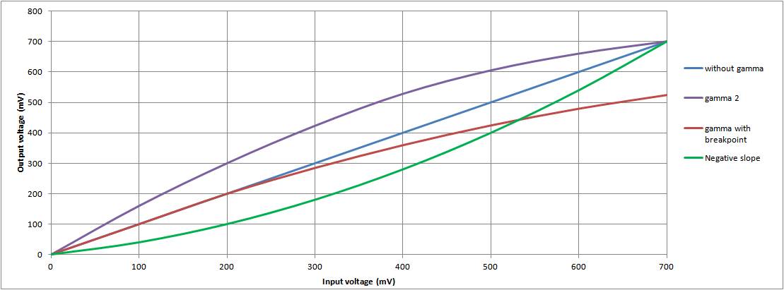

The gamma correction is also "interesting" for the blue. With these multipliers used in CRT applications it is often overlooked that all inputs are actually high bandwidth capable, So unlike to the VIM the gamma is not added to the output signal as a serial element.
The input signal is monitored (before contrast control) and is fed to a high speed difference amplifier whether the input is higher or lower than the threshold and this simply modulates the contrast voltage, even if it is only one pixel wide. Again, the AD835's all input is high speed capable.
This gamma circuit is a so called ECL inverter with emitter degeneration. It is tuned such way that if the input voltage is larger that the threshold level it produces a (linearly) proportional output voltage, depending how much the difference is between the input and the threshold. This voltage modulates the actual contrast voltage and yield a square-like mathematical function (see simulations) -gamma curve.

Gamma simulation. Note the curves are largely exaggerated, but they show the actual behavior

One question, if this is a daughter board for the VNB, how are you getting the video signal to the board (I don't see a coaxial jack on your PCB)
or, are you adding these onto the VIM actually? It seems more likely they go on the VIM since that is where you need ot remove the OSD problem right?
if it's on the VIM, then where is the ribbon cable coming from for J2?
Sorry for all the questions, but the pic of the boards doesn't tell the whole story Smile if it's proprietary, that's ok too
Posted: Fri Dec 16, 2016 5:43 pm    Post subject:
The boards are daughterboards for (each) VNB actually. The pictured boards were not fully finished when they were photographed. The input is J4 which is indeed not a coaxial connector, I considered using 75Ohm MCX connectors as well, but they pump up the cost, and I don't feel they give much in return. I know the simple pin headed connector is not the Holy-Grail for video signals but it just simply works.
For that matter the Moome card on the VIM also using commercial multipin connector, furthermore the standard 02p VIM does not even back terminate properly the coax cable between the VIM and VNB.
The input of this daughterboard is connected to either the input BNC connector directly or the the Moome card's output directly with a coaxial cable (so the video signal actually jumps through the VIM entirely), this can be done without penalty since the input is already properly double terminated, so in fact it does not matter if it is only 2cm PCB trace or 30cm coaxial cable.
For J2 a "new" cable comes from the VIM, on the VIM a passive PCB is added that collects all the needed signals (contrast voltage, the OSD signal, OSD/source control signal).
I rather decided to give a long run for the OSD signal (which is not critical) rather than slicing up the video stage as it is with the conventional VIM-VNB setups (which includes the MP mods as well).
Slicing up the video stage means you need a terminated coax cable inbetween that cuts you gain half (if it is terminated properly) As I said the VIM is not terminated properly, so the gain loss is only ~25% but in return there are reflections. With my solution this step is completely omitted, which pays back as bandwidth overhead, as the AD835 looses its bandwidth the most with high output voltage.
I hope my answer was well detailed Smile

The only thing on which I still want to improve further is the gamma correction... (but that can be disabled anyway)
