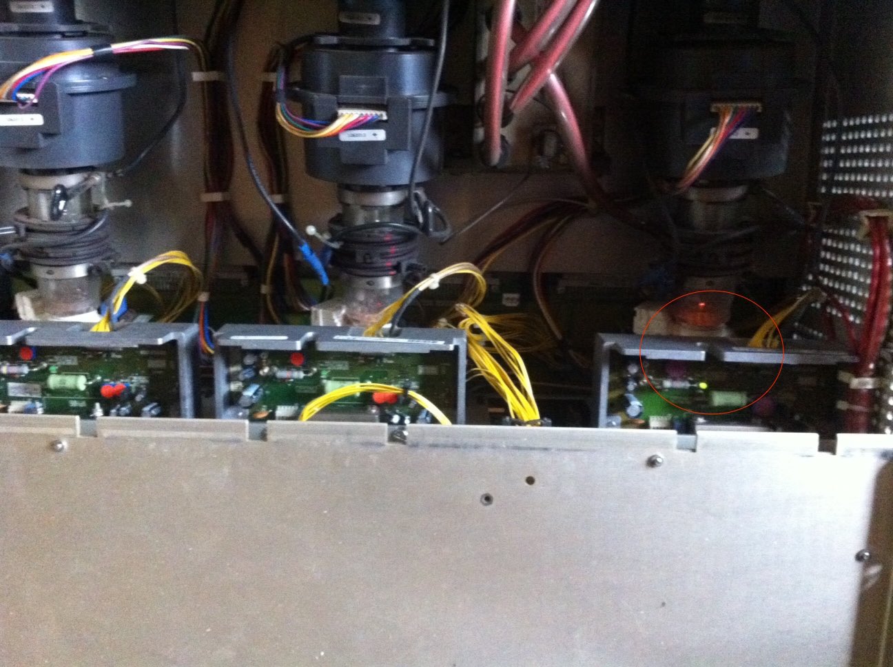

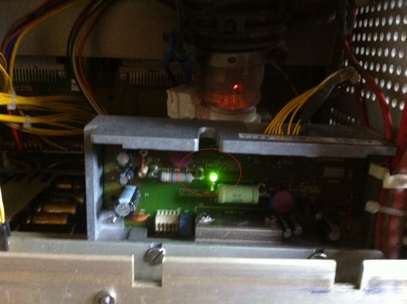

Posted: Tue Aug 02, 2016 4:49 pm    Post subject:
Hello Decibel,
Thanks for the pictures and explanation.
I did as you suggested: opened the plastic cover and then tube-cover and then started the Barco.
Firstly, it appeared to me that the noise-level was higher than normal.
Secondly, I noticed that the green led of the BLUE tube was burning far much stronger than from the green and red tube (if these where burning at all, I am not sure). Please have a look at the pictures attached. Then, after some seconds when the screen started flickering, at the same time the green led of the BLUE bulb stopped burning synchronously.
So I guess there is a problem with the BLUE bulb. Any idea what this could be?
Thanks again!
Regards.
Bert

hiddink
Joined: 09 Jan 2014
Posts: 47
Posted: Tue Aug 02, 2016 4:51 pm    Post subject: Another image
Image of three bulb, green led for BLUE bulb
3 bulbs
 Filesize:  212.61 KB
 Viewed:  9166 Time(s)
Posted: Tue Aug 02, 2016 4:59 pm    Post subject:
I think you're on the wrong track, it's either the HV splitter, quadrupler, or EHT board. I'd get a replacement splitter first. I've got stock.

Posted: Tue Aug 02, 2016 5:33 pm    Post subject:
No, ignore that for now. You'll have to change the settings again once you change the HV part that is bad, but you have HV issues (or possibly H output board problems.

Posted: Tue Aug 02, 2016 7:32 pm    Post subject:
As Curt said, the green led of blue RGB output board is not a sympthom of the issue that you described.
That could be a little bit of G2 adjustment out.
The leds of RGB output must dim in G2 adjustment screen menu, but in normal use sometimes the leds could bright.
The projector of a friend of mine showed same issue.
We saw some arcs near the splitter.
We fix the issue by replacing the splitter.
Domenico (Barco fan!)
