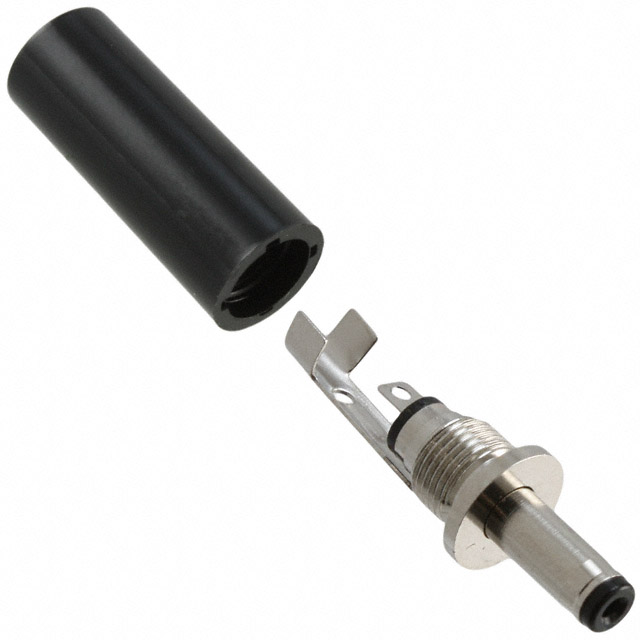

No need to cut the cable on two places.
Of course, the cleanest and best looking way is achieved when you can dismount the connector (USB or jack-side), switch the cables and mount it back. Like in the picture below.
But most cable connectors are molded and cutting them is the only option.
Or keep searching the net for negative USB to 2,5 jack barrel cable. Not so common, but they exist.
