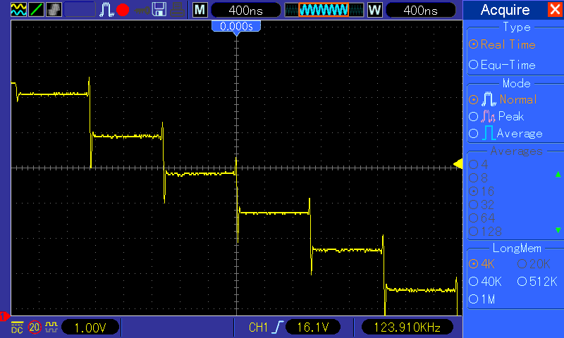

While we are waiting for those Marque guys, here is the Barco. No internal so I used an old AVAI DVD. Its all I could find in a step pattern.
 Filesize:  17.42 KB
 Viewed:  12738 Time(s)
