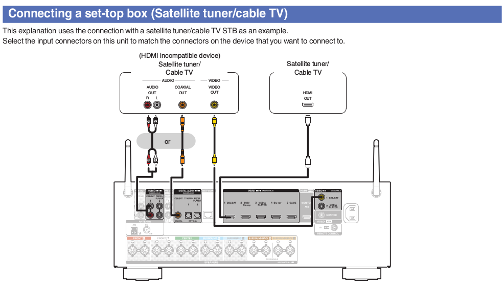

HI Larry, your receiver does indeed have a composite input. See page 52 of your owners manual:
"Connecting a set-top box (Satellite tuner/cable TV)" and the "HDMI incompatible device"
You will use the Composite video input over by the power input of the receiver labeled Cable/Sat and the RCA left and right audio on the other side of the receiver ( 2nd set of RCA jacks next to the antenna)

Thanks! I called them first, & they said that it couldn't be done. So much for factory support
