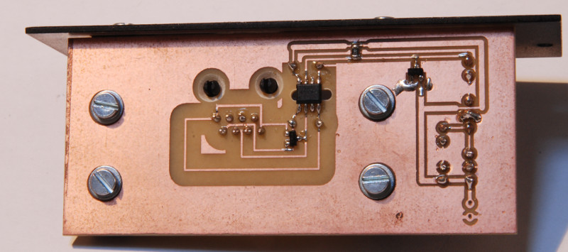

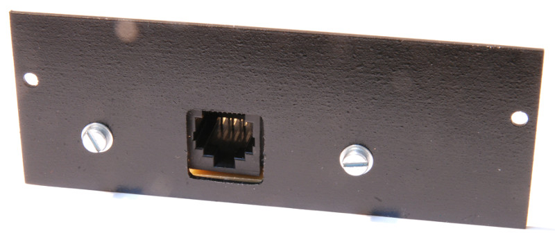

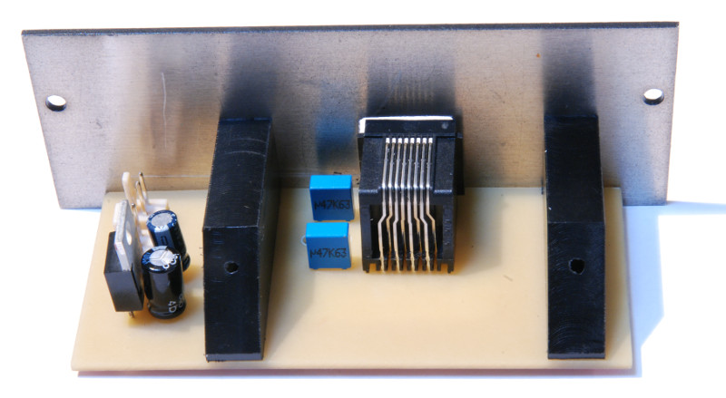

1 Wire interface
This is the 1wire interface i build. It uses the ADuM 1251 chip from analog devices, wich is a remarkable IC. It provides full isolation up to 2.5 kV with almost no external components! It uses a quite new technology wich utilizes small on-chip transformers to transfer the bus signals instead of photo couplers. It also provides all the logic required to implement bidirectional bus communication. It is designed for I2C, but works with 1wire as well. The isolation will protect the busmaster from arcing and other disasters.
Why 1wire? Because its easy. Many sensors can be atached to the bus, and with the DS18B20 a cheap precision temperature sensor (2 EURO per chip) is available that provides a build in unique serial number and comes in a TO92 case. Also i can use my home automation system (Loxone) to read the sensors and show the values in the app. PC Interfaces are available as well.
I modified the mainboard to distribute the bus to all boards (no photos of that).

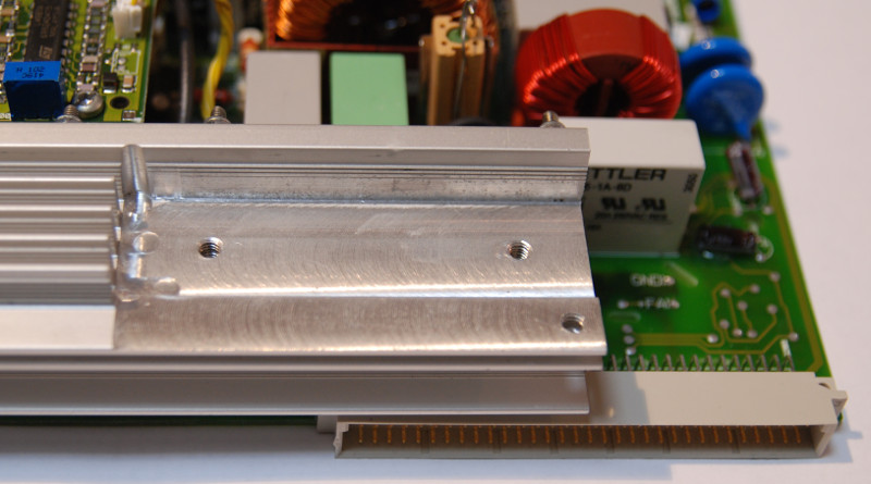

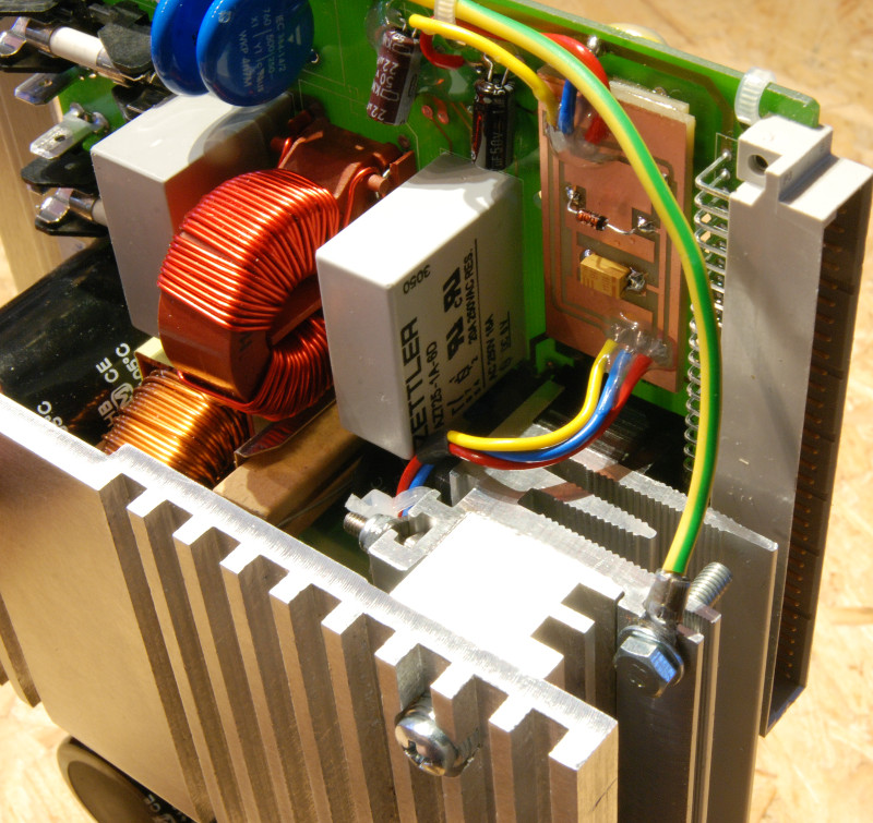

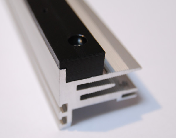

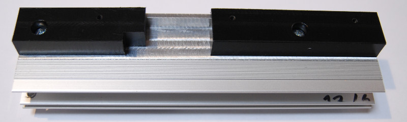

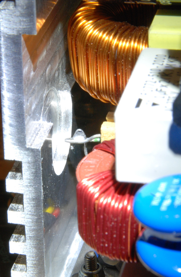

Cooling the PFC
The PFC has a small and noisy fan installed. But unfortunally the heatsink is at a position wich makes a cooler difficult. So i decided to install a passive heatsink on top of that. A small water cooler may be installed later in case the PFC will run to hot.
The heatsink is connected to GND_MAIN. This is a bad thing because when it touches anything this will give a big firework. It is also a bad thing to connect hot-to-mains heatsinks to ground, because a isolation failure can damage the set when massive currents run through the groudplane due to the voltage drop. For the PFC i connected the heatsink to the upper metal sheet wich is connected to the chasis. For the PSU and the G2 board i installed a secondary (protective) ground on the mainboard using unused pins of the connectors (no photos of that, sorry).
Then i used my milling machine to remove some part of the heatsink and made a isolator. One of the voltage regulators must be isolated with a isolation pad as well.
Isolation:

Posted: Mon May 23, 2016 8:11 pm    Post subject:
A part of the original heatsink was milled away to make the connection to the new heatsink...

the dude
Joined: 11 Sep 2013
Posts: 179
Posted: Mon May 23, 2016 8:13 pm    Post subject:

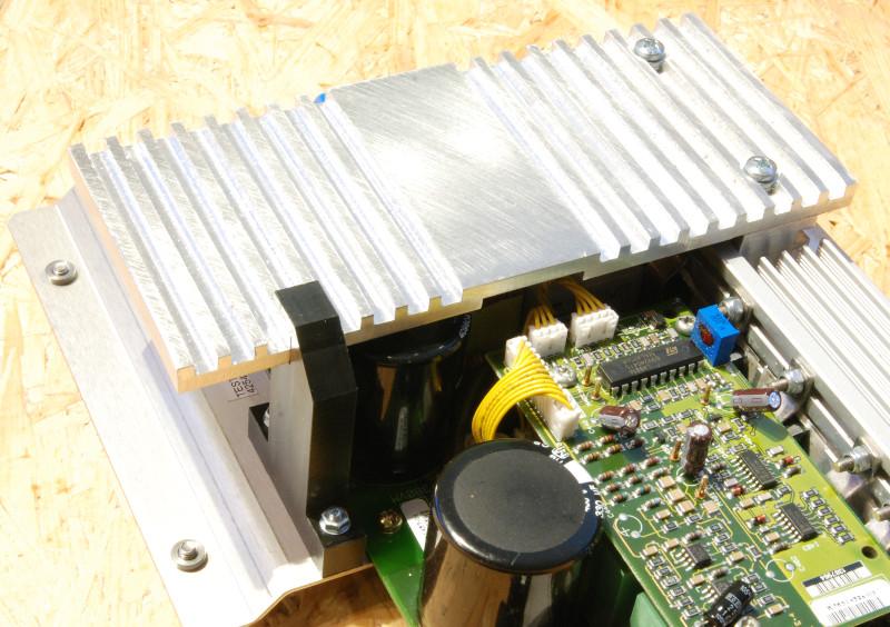

Then a new custom heatsink was made and attached

Posted: Mon May 23, 2016 8:18 pm    Post subject:
Here you can see a small PCB for the temp sensor. It contains a capacitor, a resistor and a zener diode to provide power to the sensor. Also you can see how the cooler was milled on the backside to provide proper space for the choke and the resistor.

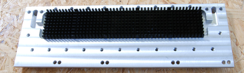

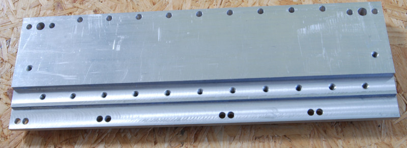

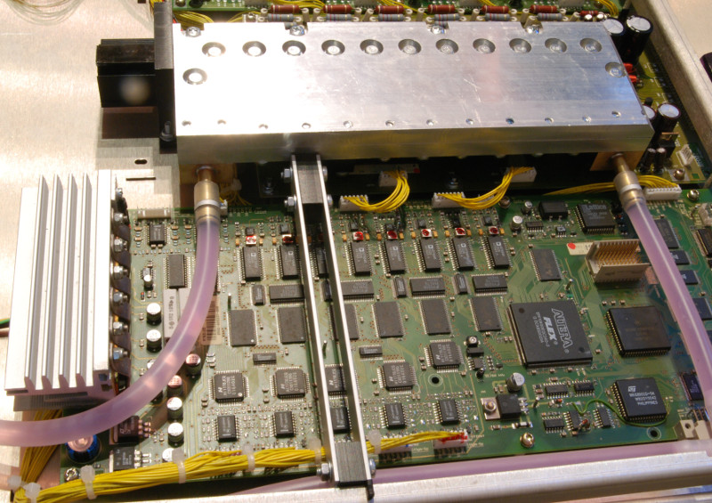

The next bad source of noise is the tray for sure...

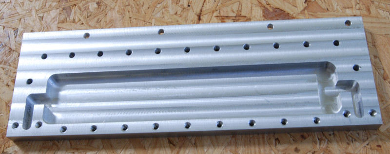

And the most demanding part for cooling are the convergence endstages for sure. So this was my next target. I used all the space available to make a cooler. This is much oversized i think, but my measurements showed that the cooler was only 1,5 ° celsius warmer than the room after 20 minutes free run (no video source). So temperature drift should be no issue any longer Very Happy
The cooler was milled of 2 sheets of aluminium, 10mm strong each. The black coolers are chip coolers (36x36x12 mm), they are glued with termal conductive epoxy resin.
Also the cooler has many screws, much more than needed for sure. But this will cause great preasure and give good termal conductivity beetween the parts wich are sealed with hylomar jointing compound. A few srews cost only time to drill holes and cut threads, i like it much oversized because i don't want the coolant to kill my set.

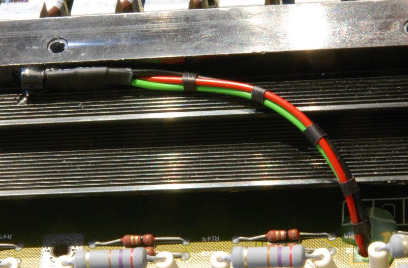

The DS18B20 temperature sensor was glued directly to the original cooler

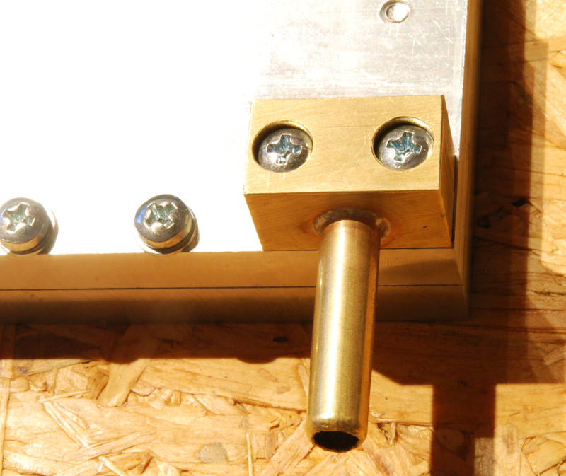

The water terminal are made of brass, 15x15 mm. The tubes are soldered into the brass blocks. The different materials are not a problem, because i use a mixture of automobile cooleant fluid and deionizised water. The glycol inhibits corossion and the organic salts in the fluid will passivate the aluminium and protect it from a galvanic reaction. Such a protection is needed anyway, because the other components (especially the radiator) are made of cooper.

The final mounted cooler!
 Filesize:  170.85 KB
 Viewed:  12451 Time(s)

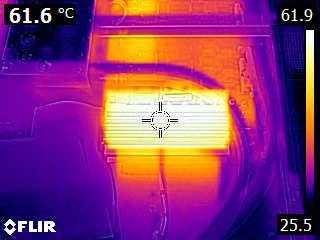

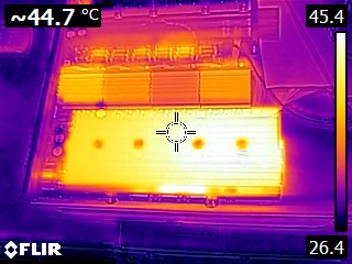

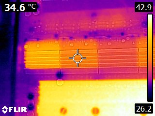

Posted: Mon May 23, 2016 9:03 pm    Post subject:

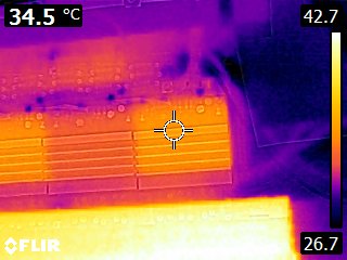

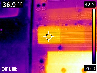

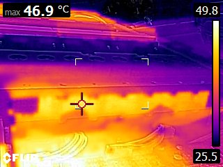

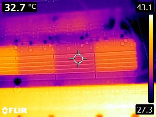

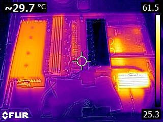

And now some results..
The PFC was 47° Celsius in freerun mode after 1.5 hours. Not sure what happens when room temperature raises and a video signal is applied. Maybe some small water cooler is required, i will see later.
The fan monitoring circuit was defeated and the conv fan was disconnected. I run the set for about 20 minutes. The conv cooler was only 1.5° over room temperature after that. But the Controller cooler was 52°. Hmmm. With the metal cover installed on the conv board the controller is not cooled by the fan, so io think it gets that hot even in a original set. When the 2. fan gets disconnected later on it may be a good idea to improve the heatsink or install a small water cooler. But anyway, 52° is Ok right now.
I made some pictures with a FLIR E5 thermal imager. The temperatues of the aluminium heatsinks are not very presicse, because they are reflective. Also the driver transistors under the water cooler are colder than they appear, the cooler is reflecting the IR light that comes from the D/A converter section on the controller board.
The coolest part is the convergence output now Cool
