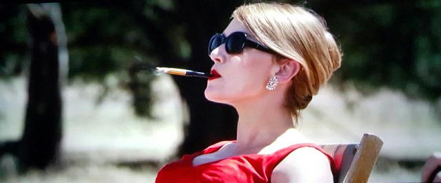

Well after a few months of single projector viewing and 4 quads later, I received a quad a couple of days ago from a forum member, wacked it in and the the beasts have been running fine for a day now.
What was different? Well I think ( just speculating here ) that the quad I received came out of an 808 and until a couple of weeks ago was in a running set, my previous quads ( even nos ones) were sitting in storage for god knows how long.
So it seems that the theory of either baking them before use or receiving them from running machines may be the key.
Its funny how you get used to one pj, to me it was fine and was saying to myself " Why did I even bother with a stack?" Well that all changed when I finally had both running and HOLY COW! AZIZ LIGHT!!!!! No going back now , brightness and punch is ridiculously addictive Thumbs Up

Nice!

Thumbs Up Thumbs Up Thumbs Up

What movie is that ?
