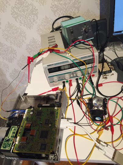

My old Sanyo died some time ago and I wanted to see for myself if it could be fooled but although it was a simple open collector output from the ballast when the bulb was up an running, the MCU did not accept it being always high at bootup. Threw it in the garbage.
Got myself a free Panasonic 800x484 LCD projector which wound's start. Turns out the Philips class D TDA-driver for the speaker had developed a short and fried the power supply. When I bypassed the power supply and injected all voltages manually, it smoked good! Lifted Vcc of it and tied the ballast output to ground and voilá - picture!
Next step, replace the flashlight with something brighter and more convenient while keeping costs to a minimum - Chinese 100 W LED. Way way too large to be able to focus good into the 50x50 mm light opening of the projector but good enough for a test.
DAMN IT BECAME INEFFICIENT!

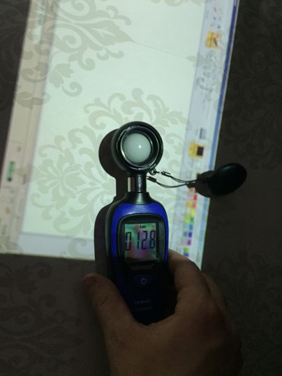

Original LED had 45 Cd/W measured with lens and 26 without it. Didn't dig too deep into the beam angle and integration but 70 lumen/W seems reasonable.
With lens, I got 12.3 lux at an 19x33 cm large "screen". Working out to 0.75 lumen while pushing in 14.8 W. That's about 20 W/lumen or a whopping total of 5 lumen if I push the full 100 W into it.
Tried removing the lens but no laptop to test with since the ground return becomes the VGA-connector so I can't use my PC with this setup but it was very similar.
Has anyone else experimented with this? I'm thinking about changing the LED setup to a fiber optic colimating lens to match the beam characteristic of the original bulb better, but that will limit the maximum power of the LEDs involved a lot.

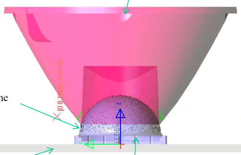

Original plan was LEDengin LZP which had 5700 lumen in 8x8 mm package IIRC, and machine an 30 mm TIR lens to accept the 10.6 mm dome on the LED. Very few drivers would fit inside the casing and this guy actually costs money. 5700 lumen is on pair with the original bulb but as far as beam angle goes, this guy coupled with seven rebel LEDs will give 2100 lumen but similar beam angle: http://www.luxeonstar.com/polymer-7-led-cluster-concentrator-optic
I'll add the drawings tomorrow when I'm not drunk.

Here is my lens suggestion for the LZP. The green hashed area needs to be lathed away. The TIR part will not function here but having the LED seated inside the lens is of far greater importance.
Modified lens

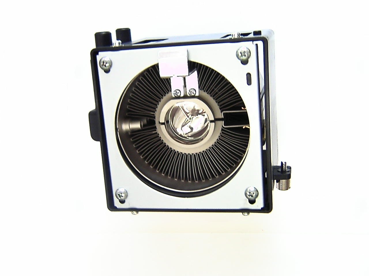

The JVC G series uses a huge heatsink on the bulb
 Filesize:  8.61 KB
 Viewed:  20802 Time(s)
winny
Joined: 09 Oct 2013
Posts: 403
Posted: Wed Apr 27, 2016 7:48 am    Post subject:
Interesting!
Is it very high power? That low % conduction will become significant once the power is high enough. Water jacketed (correct term?) xenon-lamps in multi-kW-range exists for a reason, even though they too radiate away the very vast majority.
Melifluonze wrote:
Posted: Wed Apr 27, 2016 11:46 am    Post subject:
winny wrote:
Interesting!
That does look like a set of water connections but in fact those two pipes are the electrical plugs to power the bulb.
These projectors use between a 420 watt to 500 watt bulb depending on model. At Halloween we just turn the heat off in the house and let the projectors heat the place. We heat our hands on the exhaust air from the projectors we use out side.
I'll see if I can find a better picture of the bulb.
For the JVC DILA G20U. Bulb # BHL-5003 SU
 Filesize:  85.32 KB
 Viewed:  20781 Time(s)
