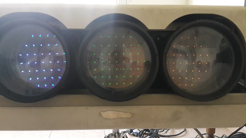

Hello Everyone,
I just got this 30 Years old Barco Vision projector, reading through this site I didn't understand what is required to make it show something.
"Generally speaking, the Vision projectors accepted a video only signal either video a composite video connector, possibly an S-video connector or via an RGB input. Remember that these sets were made pre-1990 generally and back then, video signals could be given via an RGB signal, but the resolution was limited to 320 X 240. (back in the early days of computers, that was high resolution!). Even the sets that are labelled ‘HDTV’ on the case such as the Vision 1500, the resolution maxed out at 640 X 480, and cannot sync to a modern day HDTV signal."
"Barco then came out with the Barco 400 and Barco 600 video projectors. The 400 and 600 are very similar in design and performance. They use 7” SD-187 Sony tubes with ES focus, have analog convergence, and scan to 64 Khz with 600 lumens light output. Thousands have been sold, and many are on the surplus market. These projectors must be used in conjunction with either a little plug in controller module on the back of the projector, or with a Barco RCVDS 4 switcher unit that acts as a video selector and video to RGB decoder. Note that these two projectors usually only have the RGB inputs working despite the fact that they have video input connectors on the projector. The video card was an option on these sets, and hardly any of the sets I get in have had this video card installed. Also, most of the surplus projectors do not come with the plug in controller or with the RCVDS 4 unit, so you may end up needing more components before you get a watchable picture."
So.....is this the case with the early Vision model? does it require a switcher?
Need to say that the dots pattern does appear on the CRT's but not on wall
Thanks for any help.

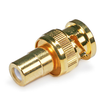

Posted: Tue Apr 19, 2016 4:22 pm    Post subject:
Get an RCA to BNC adaptor and try the video port with a Composite CVBS signal, that's the yellow jack on a DVD player.

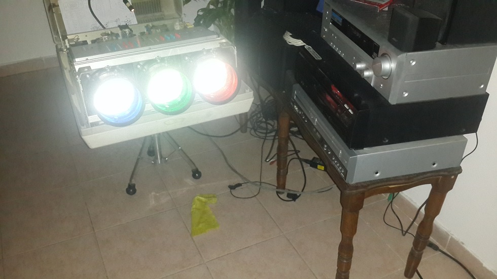

Posted: Tue Apr 19, 2016 10:05 pm    Post subject:
dang! 30 years and still kicking!! connected the BNC to the RCA (video out) and picture came up, no need to set color convergence!.... i'll be damned, Analog does Rock!.
digging into the history of this machine, it was purchased by the university of Tel Aviv for one of the conference rooms, purchased by my customer on July 1998 which took to the local dealer to service it, after that he never actualize is plan to build a projection room so he stored it away till now, boy, talking about a barn find!

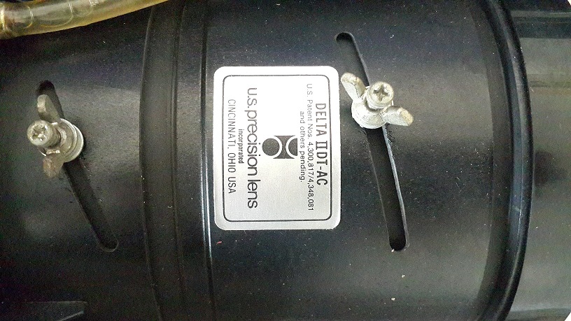

The red tube is flickering which I guess is reasonable for capacitors this age, the blue tube got air bubbles in the hose and it doesn't seem to move, what's the deal with this water? Shocked Thumbs Up

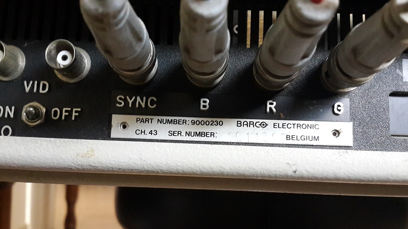

Posted: Fri Apr 22, 2016 4:01 pm    Post subject:

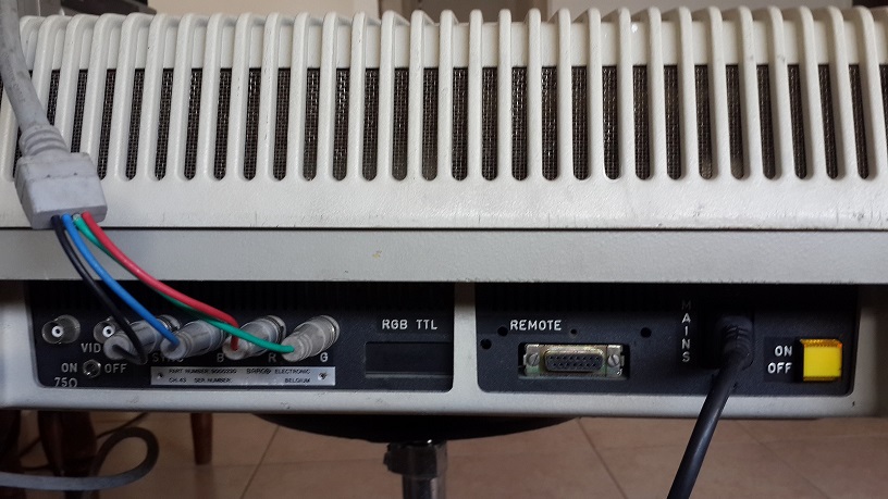

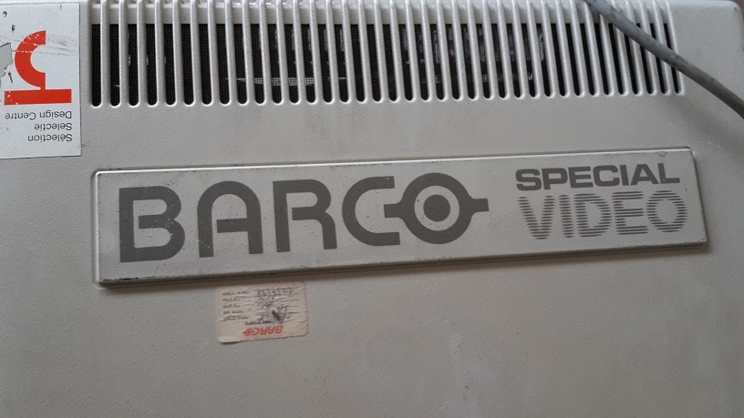

Huh you got video on a Barco special Video without the little box or the big external connection box/controller on that empty 25? pin plug labelled 'remote'?!
'Fungus' well it is a reaction of the aluminum chamber and the water/glycol mix.
Posted: Fri Apr 22, 2016 5:10 pm    Post subject:
Yes, you need that little plug in on the connector on the back. I think I still have one here for a Barco 600, not sure if it will work on the old Vision, but I think it will.

Posted: Sun Apr 24, 2016 8:30 am    Post subject:
Do I need to do something with the water/glycol mix? flushing?
Posted: Sun Apr 24, 2016 7:17 pm    Post subject:
only if it's cloudy or turned yellow.
there shouldn't be any water, but the Glycol is extremely Hygroscopic, so will absorb water thru the rubber seals.
Empty, rinse with isopropyl alcohol, and refill with either "TV coolant" or Ice Clear non toxic Glycerin based coolant
