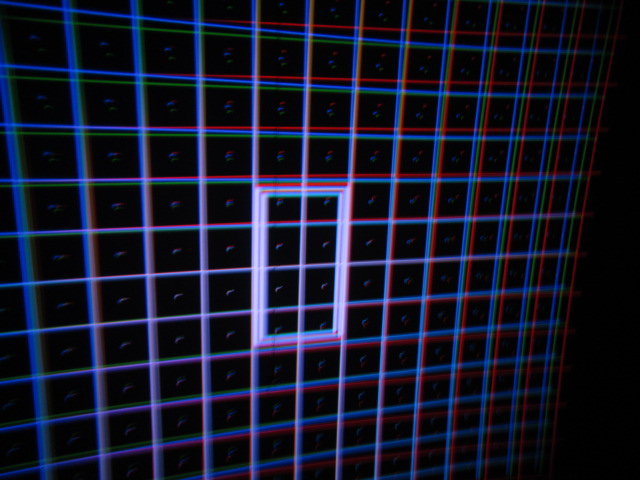

I am having problems with the Red convergence. I do a mechanical alignment to the green with the Red and Blue, and while doing a convergence, the very outer edges of the Red will not align with the Green and Blue. I hit the limit with the remote moving the horizontal bottom right and upper right on the Red. Mechanical alignment is right on top in the center rectangle. I reset all convergence settings and started from scratch from the service menu. Please give me your suggestions.
Thanks,
Mark Sad

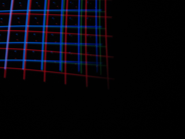

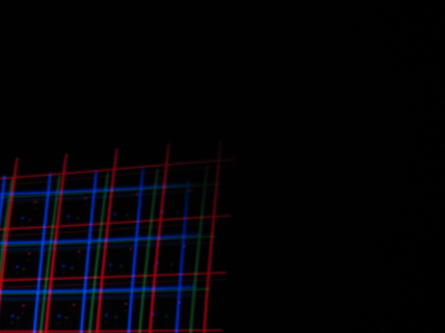

I redid the mechanical focus on the lenses with the leads unplugged. I still have about a 2 inch bow at the top and bottom Red right hand side relative to the Blue and Green. That being with the center grid overlapped on each color. Raster is centered on the tube face. I am concerned that the Red convergence will hit the limit electrically because it is so far away from the other 2 colored grids on the right hand side.
 Filesize:  113.34 KB
 Viewed:  11857 Time(s)
 Filesize:  57.26 KB
 Filesize:  50.8 KB
Posted: Sun Apr 10, 2016 9:01 pm    Post subject:
That'll converge out easily. No problem.
Generally the amount of shift available in covergence is about 1 and 1/2 grid squares. You need about HALF a grid square's worth. No problem at all.
If you have the ACON system, use it to get started. It's cool to watch it in operation anyway.
