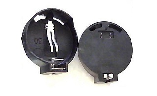

Here's another idea: Get a battery holder for a CR2025 or CR2032 battery, the battery itself and solder it in instead of the Reanata block. That'll give You a working and final solution for years. As soon as You find out that the battery is nearing its EOL, just replace it. I've equipped most of my CLMs with this and it works flawlessly. If You're fast enough with the battery change, not even the settings get lost...

Or solder some wires on the backside, apply 3V (power supply, other batteries or whatever) to it while you desolder the renata and solder in a new battery/ battery holder.
You can then desolder or just cut the additional wires again.
