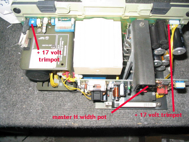

Question:
how do i service the 17v trim pod on the main power supply on a barco graphics 801s?
i read some thing about it but no details were to put the voltage meter, and what's the diffrence between the two
17v trimpods in the picture?

Only the left one in the picture is a trimpot. The one on the right side is the test point. I guess is just the wrong text right there.
Just put the black probe (crocodile) on the metal chassis somewhere, the red one on the test point (pin on the right side) and adjust the potentiometer (left side) for a reading of 17v DC.

Thank's! and do you know why my new power supply has no white block on it? only a metal plate

No idea. If you mean the big trafo, it should be there on all SMPS's from 800, 801 and 808 series projectors. Yours is missing or you are confusing the board with the SMPS2+G2 board.
Does your projector is functioning properly with this board mounted ?

weird Embarassed the one i'm using is with the white block the other came with my second pj and the boards are identical only missing white block. So the other one is no good? i don't even know how the SMPS2 looks like. I tested the board without the white block and it had the same functions as the one with the white block only my pj wouldn't act right. Confused

Oops, 12+ years and it's the first time someone has pointed that out! I've linked to it dozens of times over the years. Smile
The 1209 series DOES have a transformer on it, it's under that metal plate, and is blue!

yep, tranformer coil in a blue pack of some kind, under the metal plate Thumbs Up
so i can use it? because if my old one fails i have a spare. The only little thing i did once
used it but my image would't stop shaking.

If the 762XXX part numbers are the same, you should be able to use it. The 17 volt line or H width control may be out of adjustment..

thank's for you're warning, but i looked only at the test point (if it said 17v)of the main power supply, i looked on internet at the right setting on the digital meter and put the black probe on the chassie and the red one on the test point with a internal pattern running with a contrast and brightness on 50 (that's what the service manual said), and it actualy said 15.83,so i tweaked the pod until it said 17.01. I also needed to set the master h width to an acceptable screen size that's it. No more testing for me everything is done with the setup on my pj,

But, is your meter calibrated? If it's way off, you may have just adjusted the 17 volt rail incorrectly.
Check your meter with a fresh, brand new, never used Eveready alkaline 9 volt battery. It will read between 9.4 and 9.6 volts.
If you're getting a voltage reading in that range, your meter is well enough calibrated to be trustworthy.
