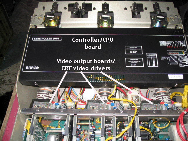

i'm trying to leave the swap for now how do i find out wich tube it is? and i got some video driver boards maybe that wil help? Also got some video noise on the white warm up screen is that normal?

it only appears on all three tubes while warming up faint lines (not the scan lines) After, the picture seems normal even looking into the tubes. this tektst i found in layout and setup tips:
RGB/Video output board(s)
The video output boards are identical for all three tubes. These boards can cause a number of problems, including spot burn at turnoff, retrace lines (thin diagonal lines running across the picture), and varying color balance as the gain of the PC board changes. The WORST thing to do when you suspect a bad video board is to tweak the trimpots on the board. A burnt tube is virtually guaranteed if you tweak these pots.

just changed the video output boards with no result Crying or Very sad still having the same isseu i guess i have to swap tubes after all or live with the problem until it really dies on me
