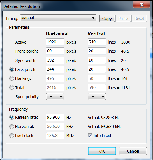

Whenever I come accross question regarding resolutions for 8" machines I always promote the 1080i 96Hz. This I find it to be the best compromise. I don't know if my viewing conditions or myself, but I find even the 72Hz refresh distracting during movies. 1080i 96Hz bringed me totally flicker free experiance, and all this for the (bandwidth/scanrate) cost of the 1080p 48Hz. The only downside is the half-frames may become visible with diagonal edges, (but this is far less noticeable for me than flickering).
I used this on my NEC 9PG xtra, and still use this with the XG135LC.
These are the timings I use, although it is for the NEC, but I think the blanking time is roughly the same for both machines in this range, so it should work.
1080i 96Hz timing
