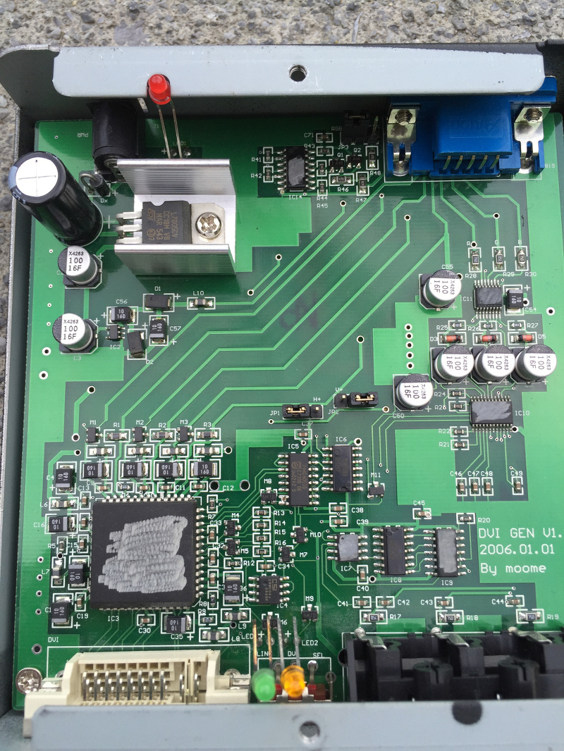

Posted: Sat Mar 26, 2016 4:35 pm    Post subject:
hi, Picree, can you open the box and take a picture for me check?
I lost the original design document in my old computer.
thanks
picree
Joined: 31 Mar 2006
Posts: 351
Location: Johnson City, TN
Posted: Sat Mar 26, 2016 11:18 pm    Post subject:
As requested. Thanks moome.

moome
Joined: 01 Jun 2007
Posts: 497
Posted: Sun Mar 27, 2016 5:08 am    Post subject:
hi, you can use either 9V AC or 9V DC, 9V DC will better for less case temperature.
