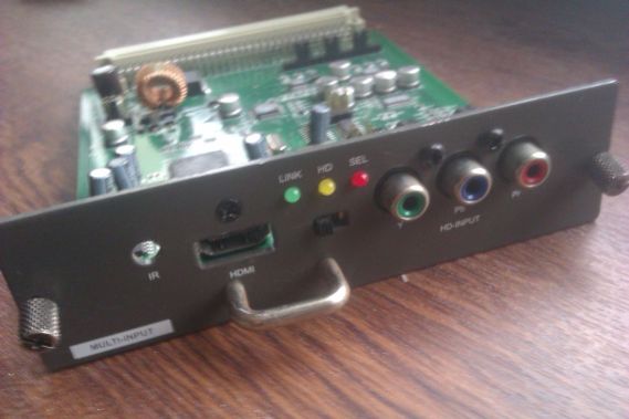

Hello. I removed my Sony G70. It was my card IFB HDMI Sony VPH. If anyone needs Ifb hdmi please write priv. Real photo. I'll send a package of Polish Greetings.

Do you reckon this unit to work in a vph1252q?
Posted: Thu Mar 17, 2016 5:51 pm    Post subject:
It will, I have one in my 1252. Just be aware you will need to set your source to 1080i or 720p when using HDMI as this card will tell the source it's 1080p compatible.

I have yet efficient projector Sony VPH 1272. card provides a very good quality of 1080p on this item.

whether there is a possibility that modding my card to work in the 808s Barco ?? Is it possible?

Yes, most likely. You need to supply the board with its specific supply voltages, but the output is still RGBHV, you just have to mate the IFB card connector with the projector.

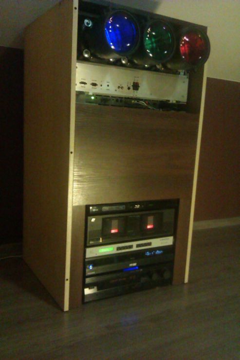

Hello. I brag about Smile. My Barco retro graphics 808s LC- element C", lenses sony g70 .... made in poland Smile

Looks great! My only critique is that I hope you have some cooling in that setup, as the Yamaha receiver, and all equipment above it, including the projector will cook themselves quickly if you don't.

I thought so. I am an amateur electronics. Physically connecting contacts Barco vs moome I can do. I have a meter, but I do not know how to measure the voltage in order to enable the association pin Barco vs moome Sad
Thanks for your feedback. I did it yesterday. You're right, I will think about additional cooling.
