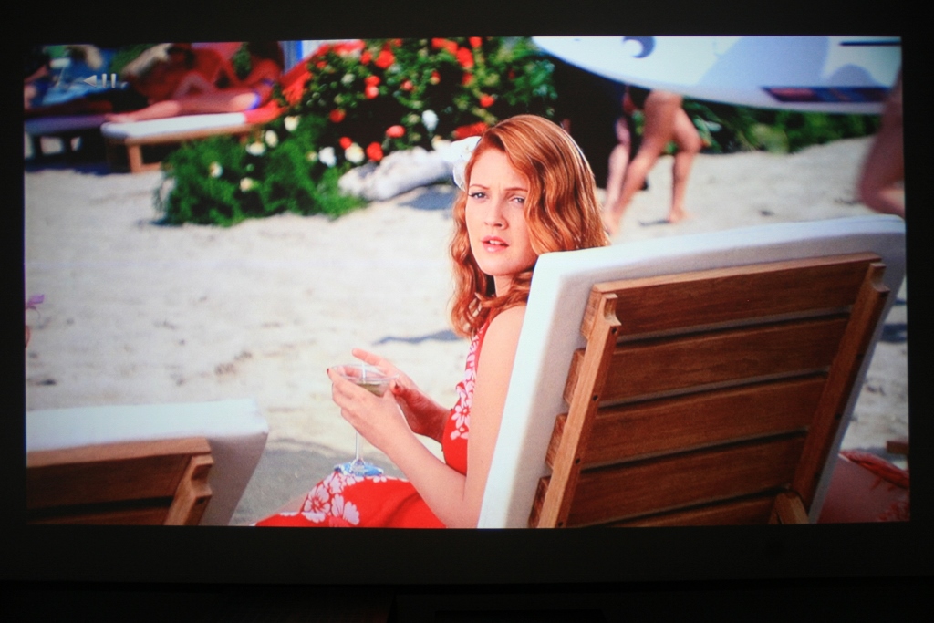

The HD144 lens do produce better colour. LC parts are impossible to find. I will also say that the HD8 REV B's don't look to bad when setup. The attached picture is my SEOS 808s test set running 1080p@60 with HD8 REV B lens.
