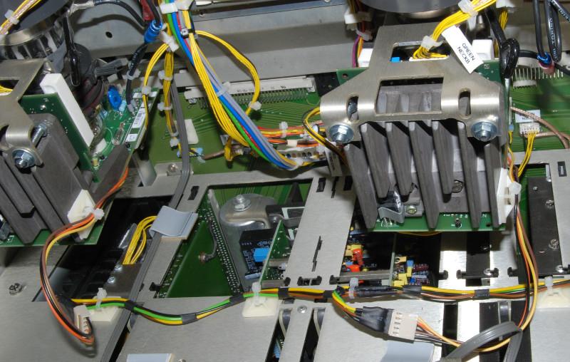

The final result. Neckboards installed in 1209s. Notice the modified brackets, the G2 kill connector and the G2 kill wire harness.

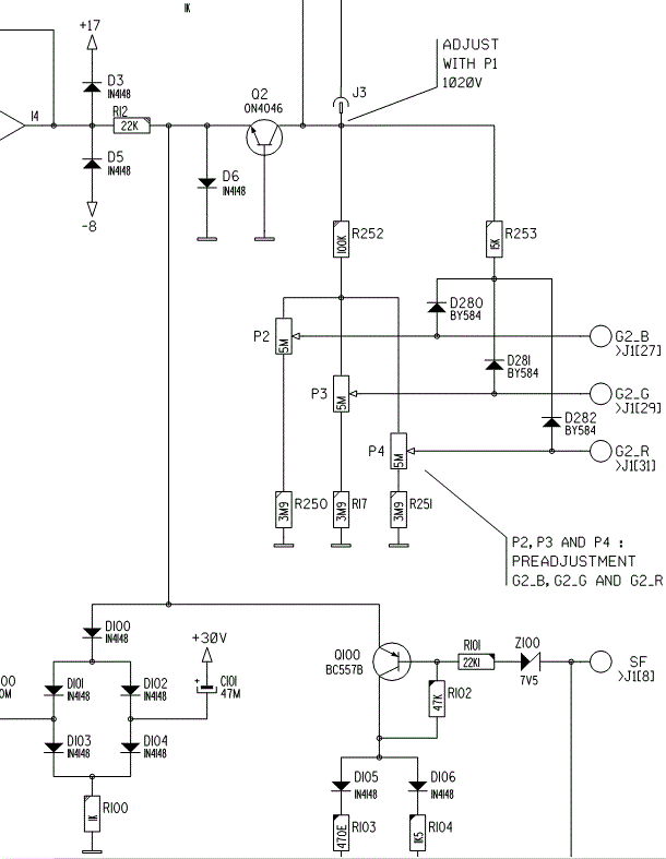

Modifications of the G2 board
G2 Kill
First of all we need the G2 kill signal. Connect a generall purpose diode with the cathode to the emitter of Q100. The anode goes to the g2 kill line on the new G2 kill connector.
I used a 4 pole connector for that. One pin of the connector is connected to ground, one pin for G2 kill and 2 pins are used for a filament security loop. The idea is to cut off the filament voltage if the connector on the G2 board isn't seated and to cut off the filament voltage for a individual neckboard if the connector is not seated in order to prevent spot burn. I cut the FIL- voltage, just because it was nicer for the wires to connect. This is an idea you may implement, but thats up to you. Anyway, if you don't connect the amp board in a 909, the filament is still powerered, G2 is present and the cathode will be at low potential, so this may be dangerous also on a original 909.
I integrated the diode in the cable.
G2 Balancing

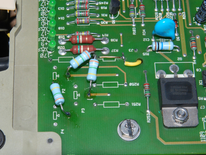

On the neckbords the G2 is pulled to ground, and this needs also some attention. If your tubes require different G2 voltages (assume they do!) the series resistor is much to low, and all G2 lines are affected. In my set this has caused much to low G2 for green, color balance was impossible and green was very dim. The G2 comes from the focus block that is connected to a 15 Kv line from the EHT, the focus block is just made of 2 resistors. This is a high impedance circuit, and so a single regulator can pull the whole G2 down for all tubes. This is why the 909 has a inverter for G2 generation, it provides a much lower impedance voltage source.
To correct this we have to avoid unessesary load on G2 first. Remove trim pots P2, P3 and P4. Remove resistors R250, R17 and R251.
Connect 1020V point (J3) to the 3 G2 lines G2_B, G2_B and G2_R using the 3,9M resistors you removed before. R252 can be replaced by straight wire in order to do that (see photo).
This should provide proper balancing.
Finally, the 15 Kv HV lead from the EHT is put into one of the focus output connectors instead of the input. This will bypass the focus resistor also, this may help a little (the focus resistor is quite low compared to the HV resistor i can't even measure - maybe there are diodes in series even if the diagram don't show any). Q2 can take the little additional load without problems.
If this does not work, one of the tubes may have a very different G2 requirement, this may indicate a problem with the tube. It may help to use higher balancing resistors in this case.
Also you may use a inverter like the 909 does to avoid balancing problems. Be sure it provides about 1Kv, ensure it will not go higher than the Uce max. of the regulator transistor. A inverter from a LCD backlight may work. You also may construct your own inverter.
But in normal cases the resistor balancing will be fine. I use a mixed set of P19LUG, PT22-22 and P19LCP and it works perfekt!
G2 kill: brown is the G2 kill line connected to Q100, blue is ground. It is not required to have that ground wire, and since additional connections may cause ground loops or currents to flow where you don't want them it may or may not a improvement to have ground wires. In this case it is just fine.
Notice the black heat shrink tubing on the brown wire, this is where the diode is inserted. I just wanted to avoid soldering the diode wire to the board, a flexible wire is much nicer. If this connection fails spot burn may result.

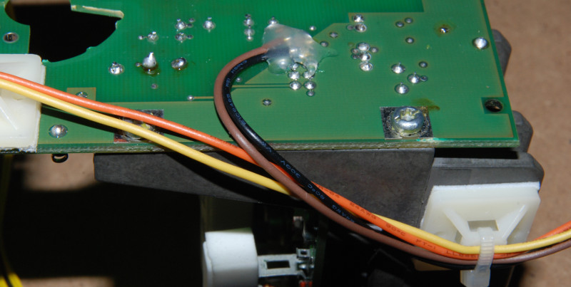

G2 kill wires on neckboard. Yellow and orange are the filament security loop, black is ground and brown is G2 kill. I used a dremel to remove carefully cut one of the ground pins (there are enough of them, and the heatsink provides ground to). Once the pin is free (double check for shorts!!) the G2 kill signal is connected there. This allows all wires go straight to the socket board, so the amp board can be removed without soldering.
You may solder the G2 kill directly on the amp board of course, you may omit the security loop, this is just how i did it.

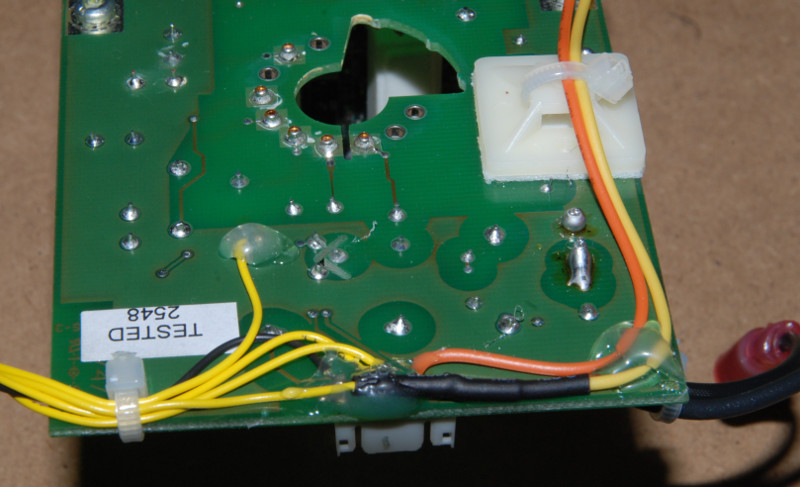

Posted: Mon Feb 22, 2016 9:30 pm    Post subject:
Neckboard wires for frame connection. This wire harness is reused from the 1209s board. The yellow security loop wire is connected to FIL- and the orange one is connected to the board FIL- connector. Be sure to have proper isolation distance on the small connector. Hot glue is always a great thing, and here it also helps to prevent arcing.

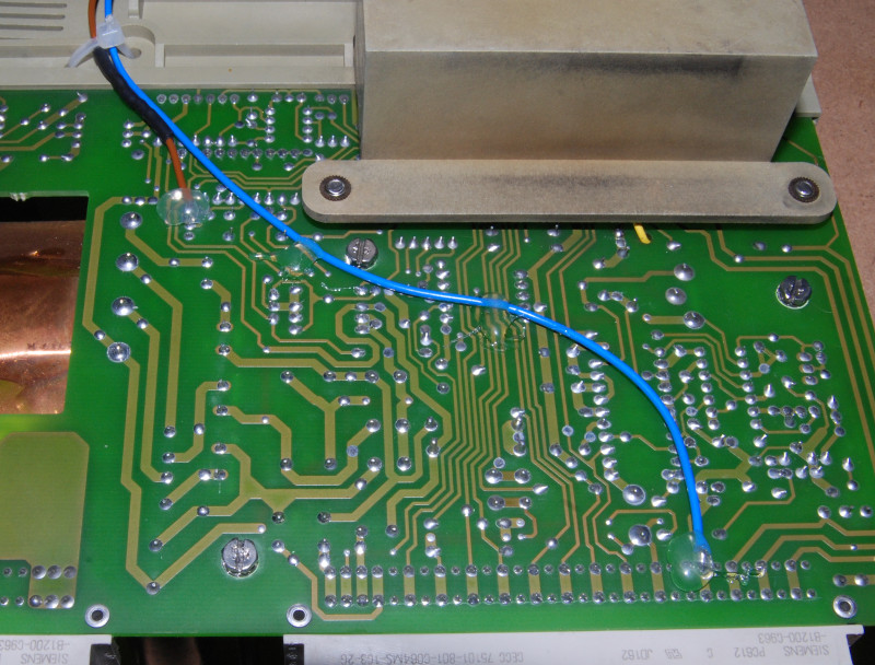

Posted: Mon Feb 22, 2016 9:31 pm    Post subject:

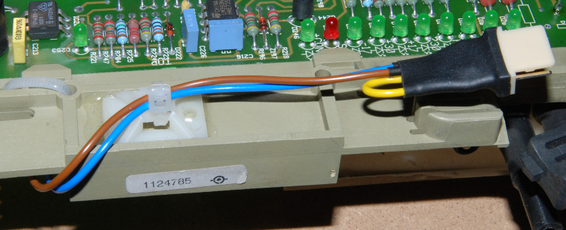

Amp board G2 kill wire. Other end is connected to the board connector.

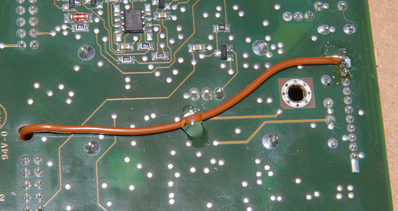

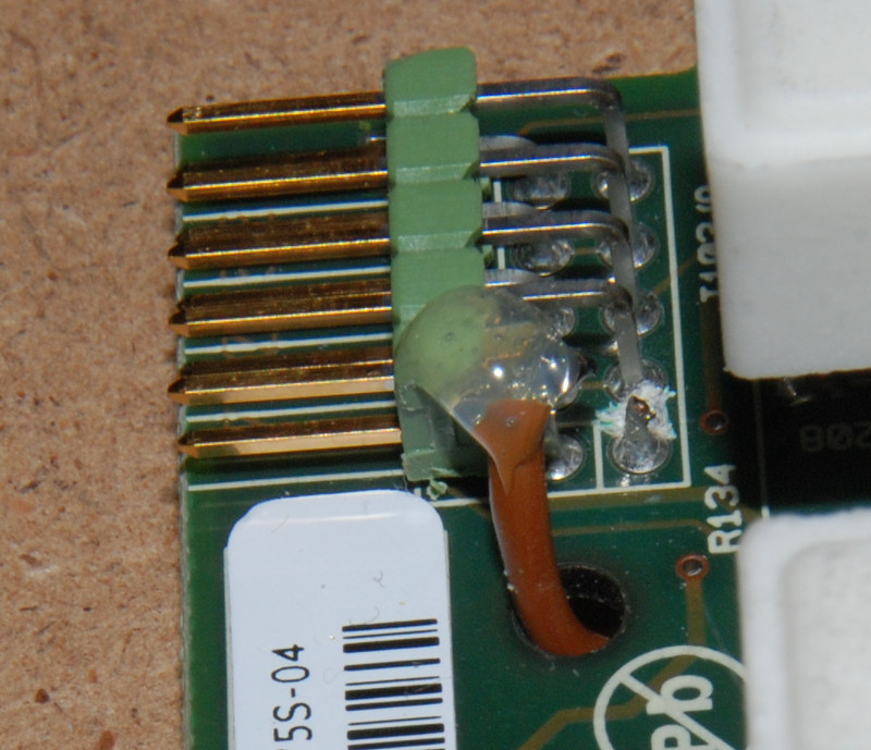

Amp board connector with attached G2 kill wire. The scratches are an attempt to cut the ground connection, but the pin is connected to the ground plane inside the board. So i just cut the wire.
 Filesize:  142.45 KB

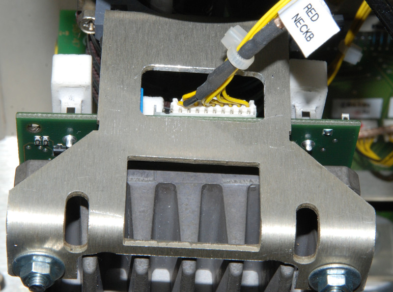

Posted: Mon Feb 22, 2016 9:33 pm    Post subject:
A closer view of the modified bracket with the connector in place. Notice the correct placement, the pins left beneath the video cable are ground and G2 kill (left outer pin).

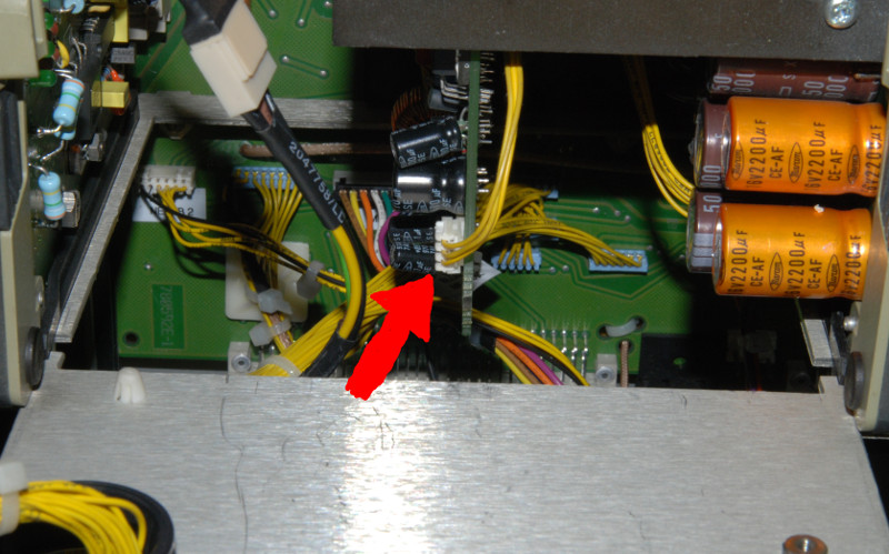

Posted: Mon Feb 22, 2016 9:34 pm    Post subject:
The last resort: If something goes terrible wrong and your tubes lights up bright this connector on the SMPS can be pulled in order to cut filament voltage. It takes about 30 sek. for the filaments to cool down and stop emitting. But for sure this is not the best way to power down CRT.
