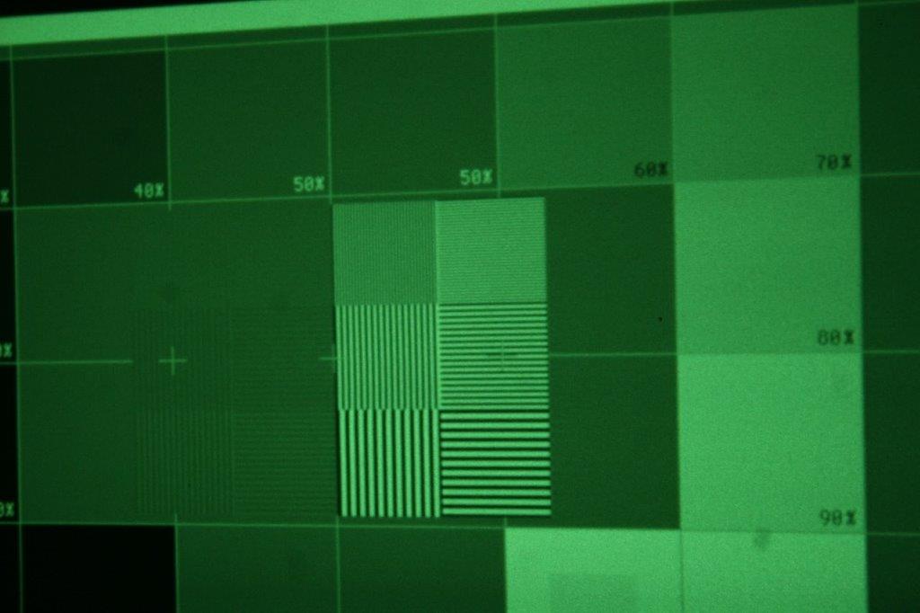

Posted: Mon Feb 15, 2016 10:52 am    Post subject:
SEOS 808s 1080p@60. I will get some during the week of 817@72
