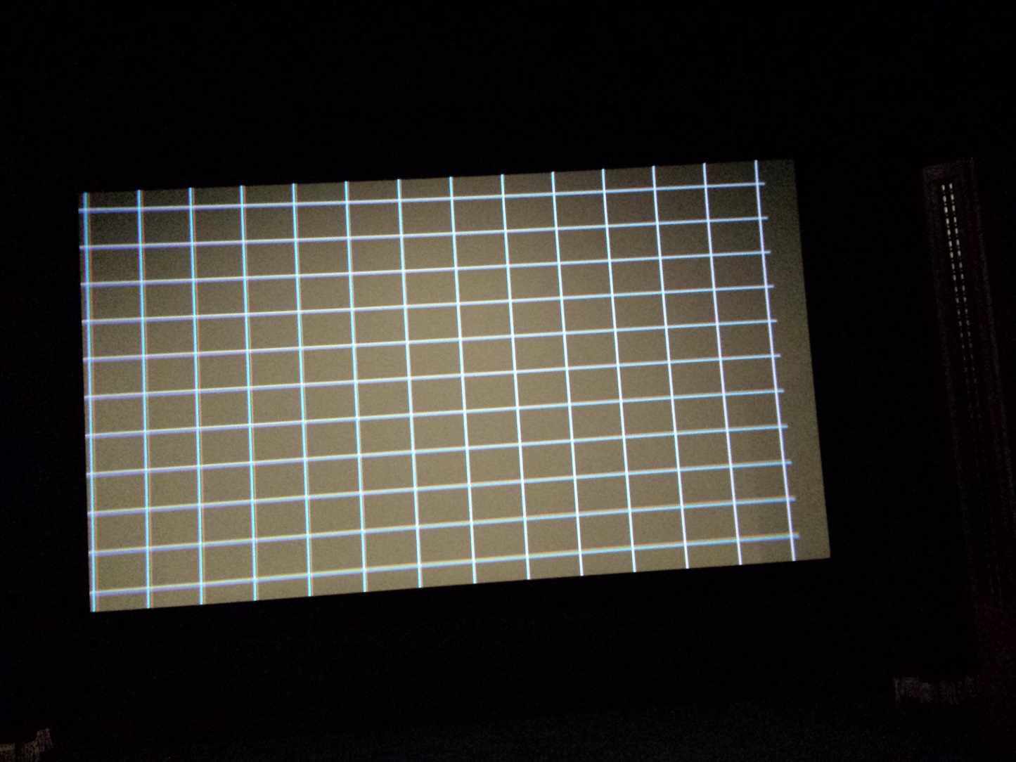

Last week I noticed that I had accidentally left my project on for a week with no input. I watched a movie with no problems, but when I turned it on this weekend, I noticed that the convergence was way off and the picture was tilted. I let it rest for a day and tried it again. It seemed to go back to normal for a few minutes, but then the picture changed to where it's several inches short on the right side. The convergence looks good other than that. Did I fry something?

Is the projector recognizes the preset saved for the actual input, or does it give a *new signal* message? If it recognizes the preset, then try to adjust convergence/ geometry to see if you are missing any range of adjustments?

It recognizes the preset for the input, but no amount of geometry adjustments fixes the problem.

Can you post a picture with the cross-coarse pattern to see what adjustments are off?

Here's a pic.

Red looks to be slightly off, I'd say it's the C-drive board then, but a major failure usualy throw an error code.
