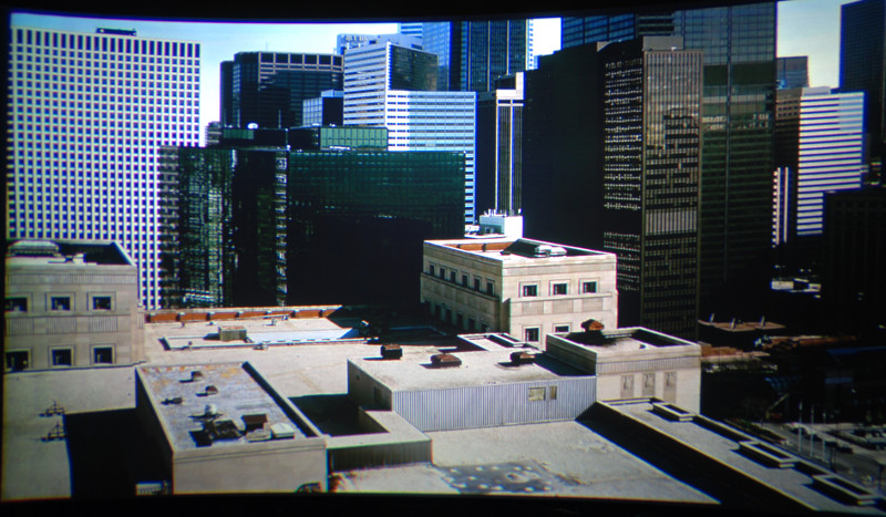

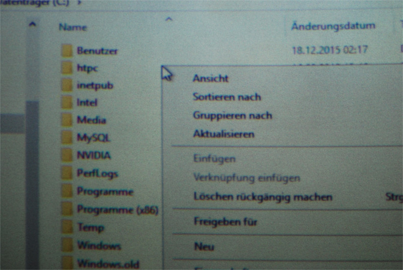

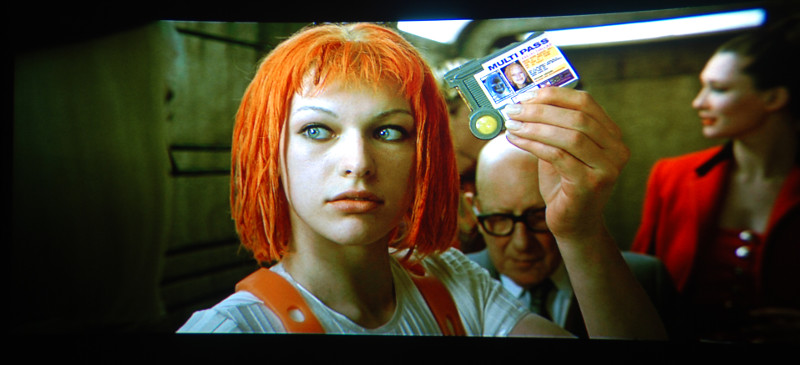

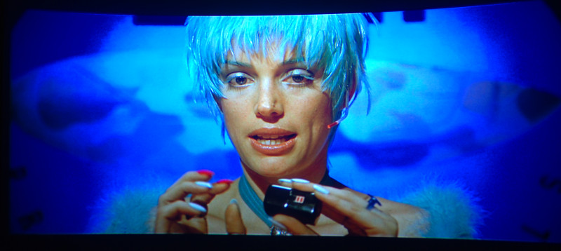

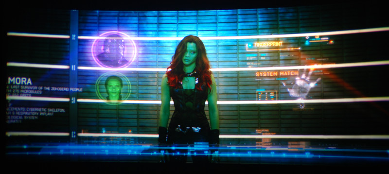

last weekend i managed to install Barco 909 neckboards in my 1209s! Since the ABL and blanking signal and supply voltages are exactly the same this was easier than expected. Only G2 voltage supply was an issue. The picture with the 909 boards ist really stunning Very Happy I also replaced the HFA1100 Op Amps on the switcher and RGB driver board with THS3201 (1.8 Ghz) a while ago, so now my set should have more bandwith than a stock 909. Unfortunally i don't have the proper equipment to prove that.
If anyone is interessted in this stuff, i could try to document how this can be done. In fact the only board that must be modified slightly is the G2/Diagnostic board.
Some screenshoots:

Screen shots don't always convey the improvement. What would you describe as the differences?

Let me try to give some answers...
THS3201 vs. HFA1100
I know that this isn't the bottleneck. The real bottleneck was the neckboards for sure, and then the gain control multiplier AD835. But the op amps are much easier to replace since the THS3201 is pin compatible and very similar except for better bandwidth and much better rise time. Thats the reason for replacing it first. The "only" problem was to get rid of the oscillations, this was much harder than expected.
Gain Control AD835
I plan to replace this, but this is more complicated. I have ordered ADL5391 also, but was scared away just by the size of the package Shocked I plan to make a very tiny pcb with this chip on it some day to replace the AD835, but that would not be easy. The soldering really scares me. I think i need a microscope or there is no hope for it.
Gamma corrector AD835
I believe the second AD835 (I203/I403) is not an issue. In fact it is not in series with the signal, it just applies a litte of the video signal multiplied with itself to the inverting input of the second op amp (I204/I404). So even if this signal is missing completly, gamma will be slightly off but no information in the image is missing. You don't really need gamma correction on fine structures, if this stage forms a lowpass you loose almost no quality in my opinion. Different frequency responses may introduce some ringing here, but i believe that is barely visible. I would keep this stage as it is. Especially with the stray capacitance in mind that a replacement circuit that is mechnical just a litte bit larger would cause on the inverting input of the current op amp (stabilty issues, this is *VERY* critical). Also the inverting input of a CFA is current driven, so the output impedance of this multiplier may also be critical. Maybe not. Just keep it, it only equalizes the gamma response of the different phosphor types for the individual colors.
THS3201 and oscillations
I had issues with that on the rgb driver board and it took days to get rid of it. A combination of this did the trick:
- playing with the feedback resistor network (this sets gain AND bandwidth)
- adding a rc lowpass to the output (between the output and the load, of course the fb resistor need to be connected straigt). It was something like 25pf / 4,7 Ohm, i don't remember the actual values, i tried many things. But i have noticed them somewhere. It is important to place the series resistor as close as possible to the output lead, there should not even be a milimeter of pcb track between the output and the resistor.
- Removing parts of the groundplane (not sure if this is really helpfull, it was just a idea i tried)
- And finally most important: Removal of ANY peaking component. Its a bad idea to add a capacitor to the inverting input of a cfa like barco did. This is a NO GO.
Maybe some of this is bull**** - im not an expert for CFAs, but it worked for me.
The Screen
Yes, its curved. Its a Kappa Line board painted with aluminium paint.
The image quality with the 909 boards
Well, its hard to be objective without a direct A/B comparsion. In general i would say the image is sharper in general. Also it seems to look cleaner than before, i guess this is because of massive peaking of the original VPH08. Remember, this video pack was rated for 85 Mhz only and Barco added a lot of peaking! And there seem to be slightly more details visible in darker areas (this may be a subjective impression, but i think so). Maybe because because ABL is done via G2 and G2 is more precise now? With the old boards there was a quite visible difference between 1080p48 and 1080p60. Now 1080p60 is almost as sharp as 1080p48.
I will try to explain how to replace the neckboards soon, stay tuned!

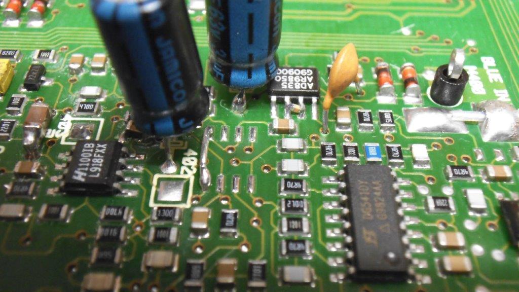

I removed the Gamma chips a while ago. Added a jumper from pin 4 to pin 5. This helped reduce noise. Noticeable on the blue mainly.
I also added a 22pf cap from Pin 8 to ground (gain control) on the AD835. This reduced the noise level quite a lot on the 808s.
There are a few other changes I made that also helped. They are listed in the SEOS thread.
