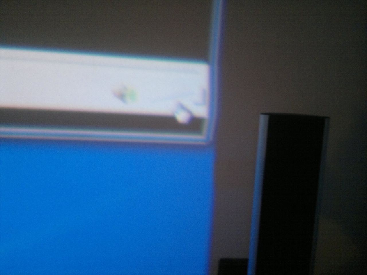

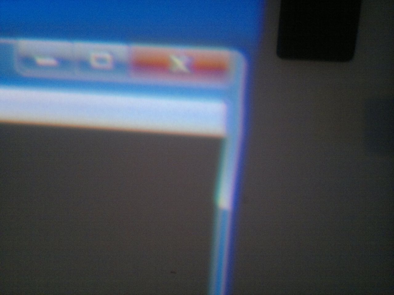

So here's a few pictures... It's misconverged (didn't do anything to it since replacing the C-drive board) I know, but you can see the problem. Wherever there's a white or near-white area, the outer edges 'bend'... this is not very apparent unless the white part is over half the total width of the projected image... Possibly related, I've had the image flicker for a fraction of a second a few times when I turned the set on today to snap these pictures... there were no sounds of HV arcing...
You mean the board standing vertically in the rear corner of the chassis opposite the two flybacks right? I don't think I've seen a switch on either of those when they were out of the set... where would it be located?

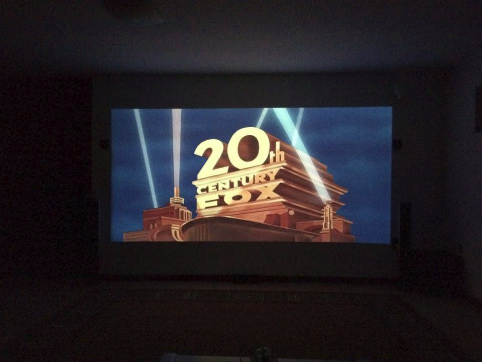

Here's a 'before the fun started' pic.
