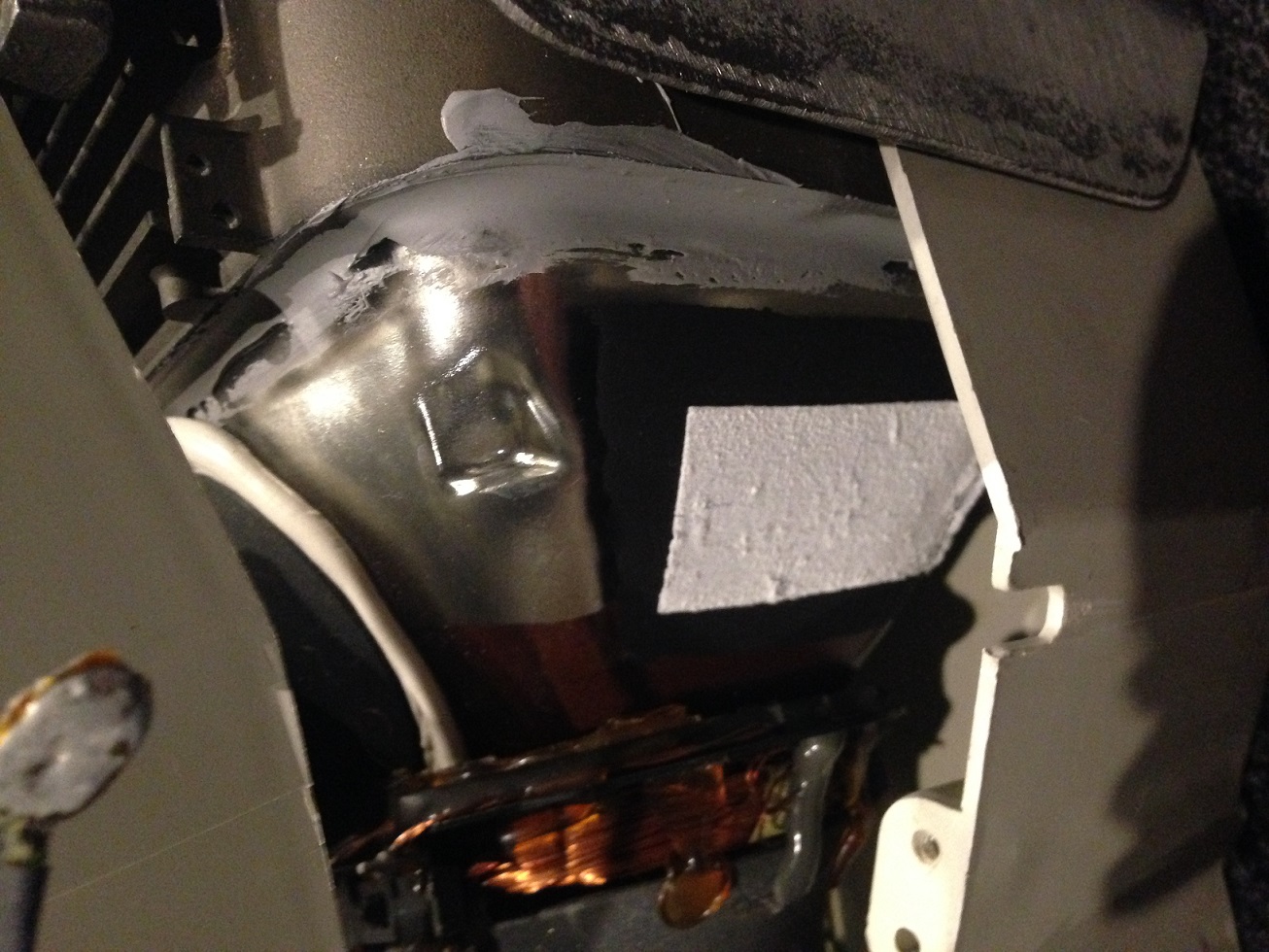

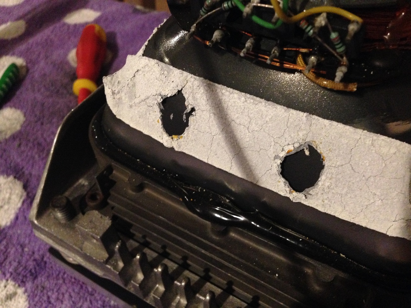

I have a M8500 that I kept in a storage shed for 5 years inside a supposedly airtight custom road case and the small amount of moisture trapped within caused almost irrepairable damage.
All my X-Ray shields were useless and the ground straps around the tube bells were completely corroded. I had to replace the carbon film layer and the ground straps which took research and a heap of time.
Will post a pic if I can.

Right-O
Here it is, moisture damage in a road case
The first picture is the bottom of the tube and the 2 circles are where the ground leads attach and run back to the VNB. The second picture is the side of the tube - obviously the white powder is meant to me grey metal.
Awesome.
Hope it helps
