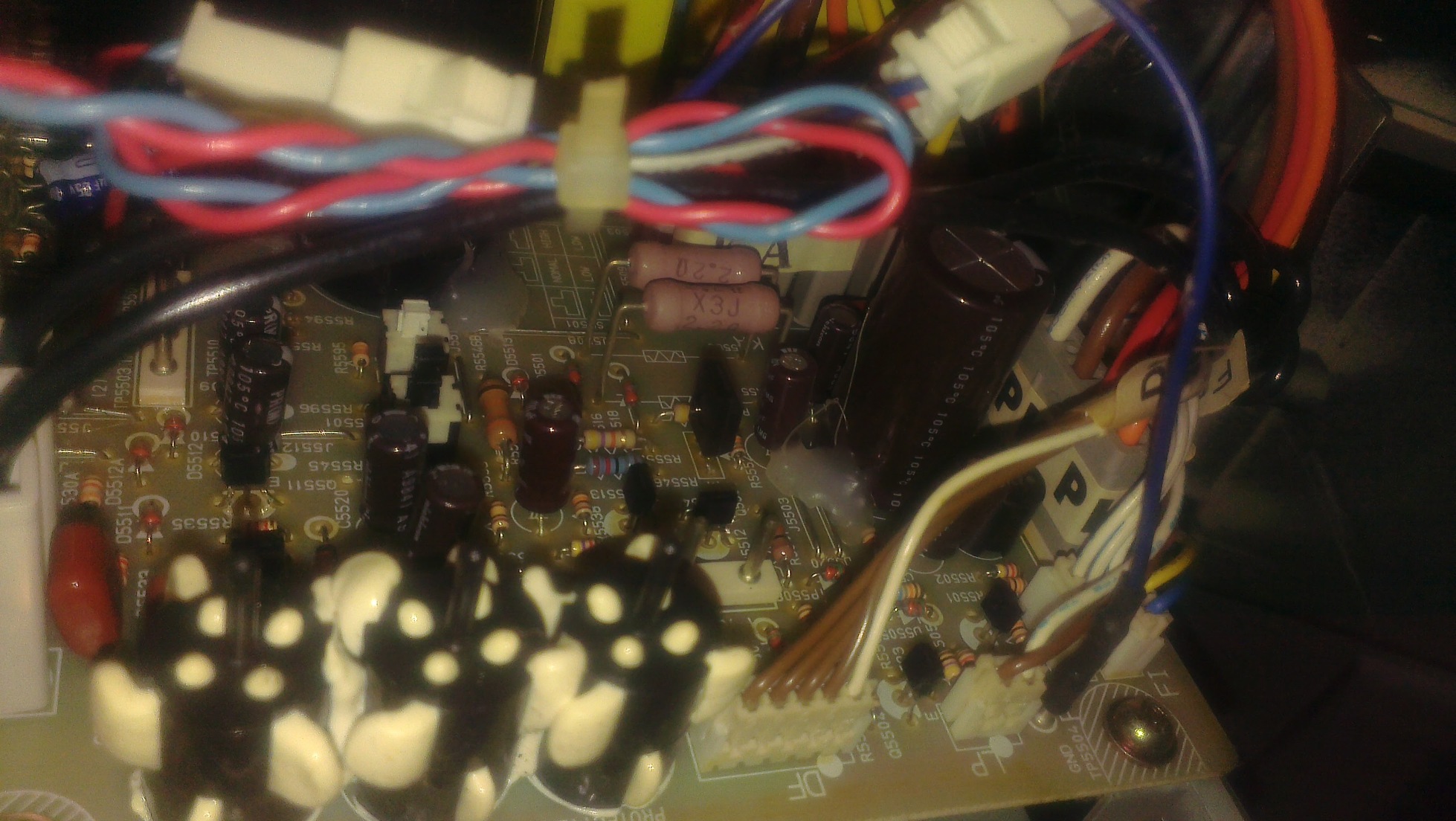

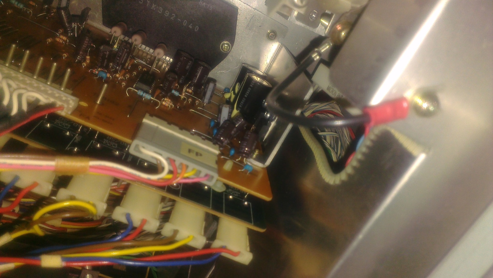

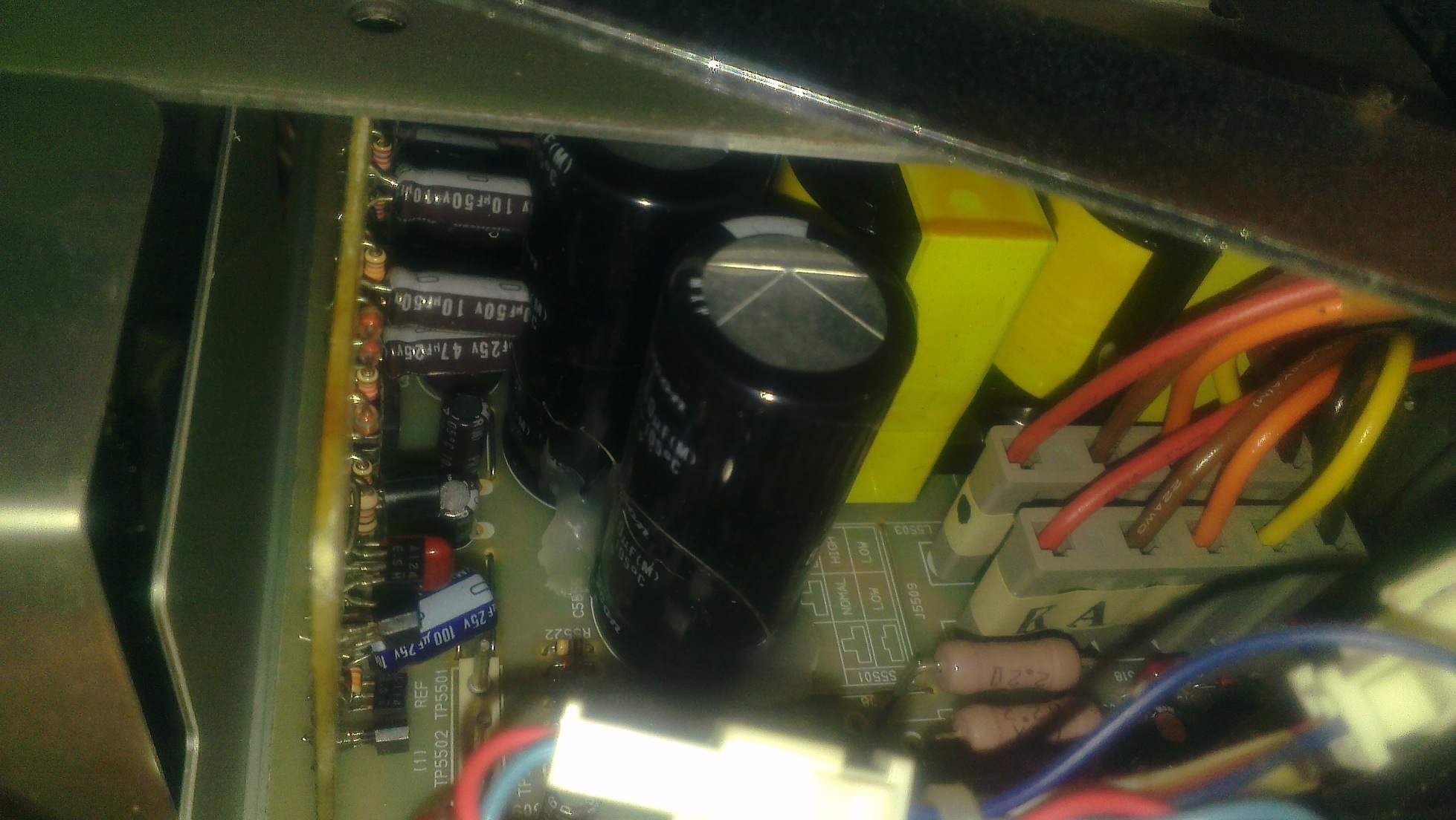

Fair enough Curt, I appreciate your swift reply. I do have a soldering iron, so I am tempted to replace the caps...is there a list of the caps that I could order, or do I have to make an inventory list by inspecting each board??
I did take a summary look at the caps I could see after opening the cover; nothing that looked to me like leaking caps: no visible bulging at the top or residue at the bottom. Some of the bigger caps looked like they had glue or paste between them; I attached some pictures.

Posted: Wed Jan 13, 2016 6:25 am    Post subject:
I'd still rather want see a picture about the problem. I've went through a few PG xtras until now and yet to see one with leaking caps.
