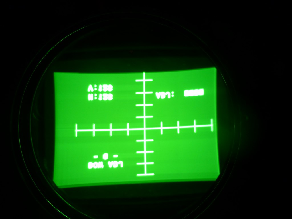

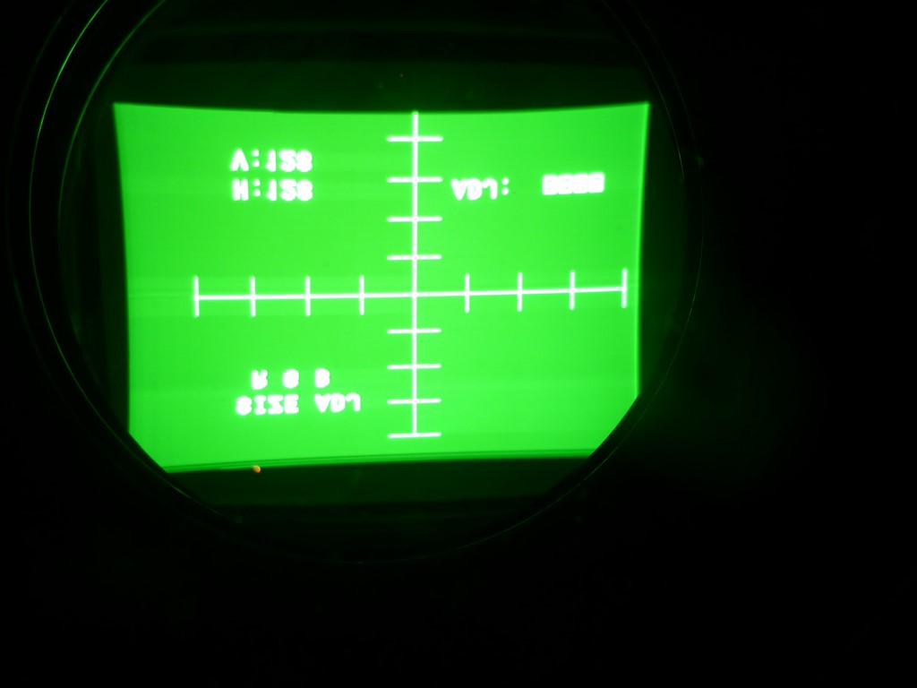

Posted: Wed Feb 03, 2016 11:03 am    Post subject:
Here the rasters with SIZE, ZONE and BOW at 128 (factory settings)...

Posted: Wed Feb 03, 2016 4:46 pm    Post subject:
Ok, sily question: is this looking the same projected? Looking into LC optics can be funny sometimes.

Posted: Wed Feb 03, 2016 5:43 pm    Post subject:
Hi gjaky,
Thanks for your message.
Good question!
Yes, projected raster has the same shape...
It's very difficult to make rasters adjustments with their shape. And a lot of phosphor surface is lost on each tube.
Posted: Wed Feb 03, 2016 6:09 pm    Post subject:
In this case I'd say you have some problem with the projector.
Just one more idea. I don't know how the changeover between ceiling and floor instalation goes, but are you sure all the connector (especially the convergence) also set for the proper operation.
