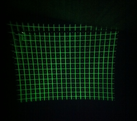

Hello Curt,
Thanks for your reply, I attached an image of the test-pattern. As you see, it is not square...however, the angle and position of the projector to the screen should be fine (according to the manual). Were/how should I proceed to get a perfect square or (rectangled) test-pattern?
Thanks again in advance!

Posted: Wed Dec 09, 2015 5:19 pm    Post subject:
What you have is normal. Follow the manual and do a full set up step by step. Your lens focusing and/or Scheimpflug adjustment is off as well.
