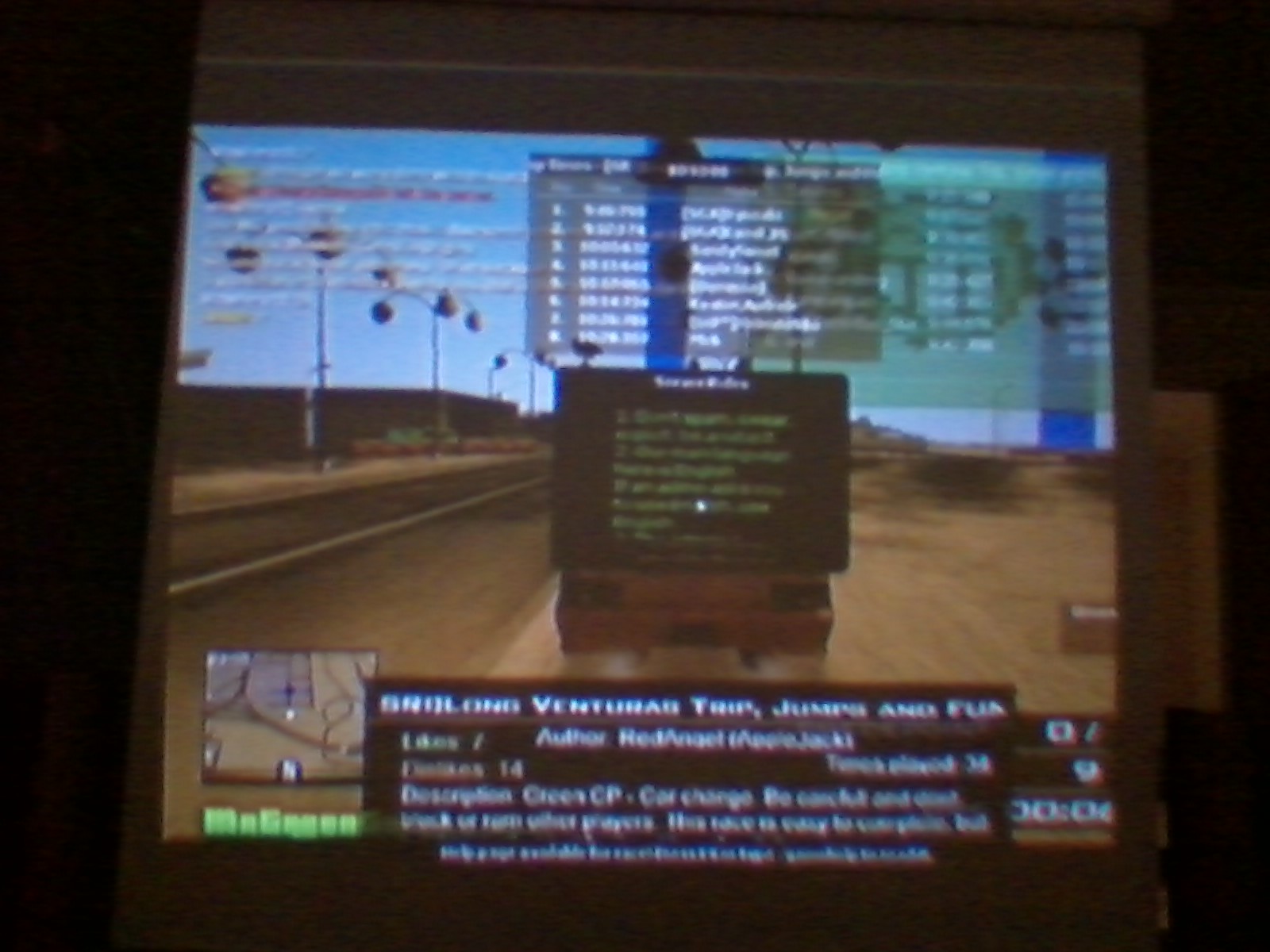

i want to know what screen to use for gunshooting when i did shoot at screen i got no registered shoots in house of dead on sega saturn but now i have it in top. also what type screen is best for gunshooters games. crt is combatible
what screentype should i choose for a gameshooter
seleco svp 310

Buy a bigger bore gun, the screen is still lighted.
Posted: Fri Oct 30, 2015 7:58 am    Post subject:
You need to turn the blue tube up a bit for gun games, the Guncons work best, the Saturn guns need a fair bit of blue brightness.
I had the Saturn guns working fine on my XG and 9PG, if your screen is too big you wont get it bright enough.

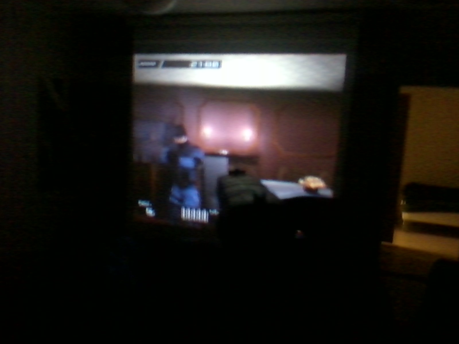

Embarassed i failed my screen i got no hits i dont know what to do i got to the ... on seleco remote hold it for 2 seconds and press exit 7 times go to video options in installation mode set brightnees and blue stretch dont know that to do do i have to buy something image brightner? can you show me in manual on cuurtepalme seleco 310 350

The projected image may be too dim for the photocell in the gun to register. You may need to go to a smaller image.

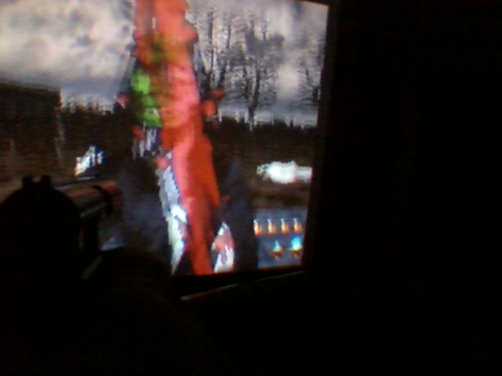

guncon 2 works on ps2 slim i think my playstation will work in guncon not sure about namco blaster Very Happy going to buy a ps-io.com/ for this Laughing

Posted: Sat Oct 31, 2015 3:59 am    Post subject:
That Seleco will be a bit small for the job if the screen is over 70 inch, as good as the 07MS tubes are for this purpose theyre just not that bright.
What you need to adjust is the blue level at the white end of the scale, leave the blue dark end of the scale dark.
Posted: Sat Oct 31, 2015 4:04 am    Post subject:
... By moving the projector closer to the screen. Smaller image on its own wont change anything if the projector is still too far away.

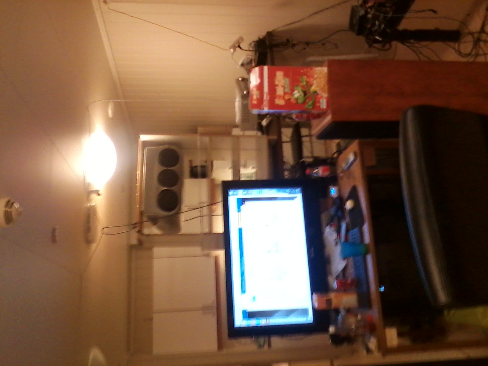

i get blurry image. i dont know how to get sharp image
using hdmi to rgb to composite

Posted: Tue Nov 03, 2015 9:03 am    Post subject:
You cant change that Seleco to auto set up.
You need to focus the lenses if you move the projector, the front knob does corner focus, rear knob does centre.
Seleco projectors are pretty ordinary machines, if an NEC comes up theyre a huge step up.
