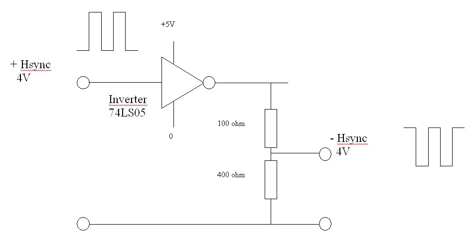

I've made an inverter for the H and V sync signals with a 7405 like the schematic I attached.
I tried every resolution above with all possible settings. That means selecting a resolution, look at the picture, invert the H Sync signal, look again, invert the V Sync signal, look again, selecting an other resolution and start inverting again. There was no picture or a disturbed picture or a picture with to much green in it. I tried this on port 3 and on port 5. With the current hardware it seems not possible to get a right picture.
