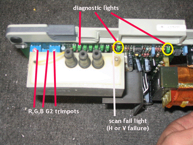

After screwing everything together again no image. So again, lid off: no red lights on EHT, the red led on the G2/diagnostic board was off but there were two green lights off as well: the single LED on the right side and the only LED after the red LED. (see attached image, the yellow circled LED's are off)

Circled in yellow are the LED's that are not on.

Thanks for your reply. I have already tried powering up the projector a spare g2 I had laying around and with the g2 from the other projector but the resistor keeps burning.
