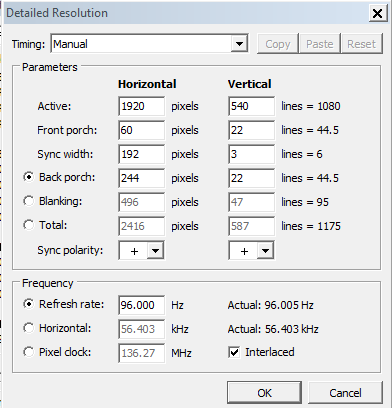

Posted: Sat Sep 12, 2015 9:53 pm    Post subject:
Sure thing. I just cropped the details of the Custom resolution utility.
1080i-96Hz on a NEC XG-1351.
1080i 96Hz for NEC XG
