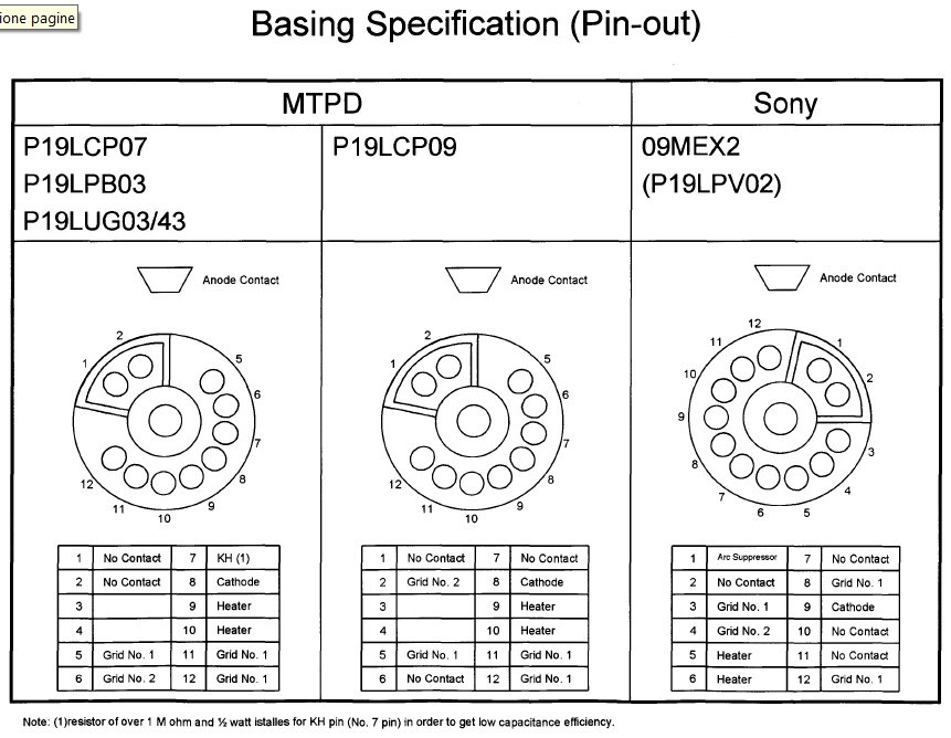

Hi
I am about to put in some P19LCP tubes in a 9500LC ultra equipped with new style neckboards and P19LUG tubes.
I know the pinout for the 2 tube types are different and I can see the new necboard apparently is preparede for both types?
So what I think I should do is to remove the strap from A to B on the backside of the new NB and make a wire that connects A to Pin 2 on the LCP tube.
What about the NC pins 1 and 6?
Should they be connected to ground the same way NC pin 1 and 2 on the LUG tubes are?
And what about Pin 7 (KH(1) on the LUG types). It is apparently only a 1 meg resistor to ground , so I suppose I can leave that be?

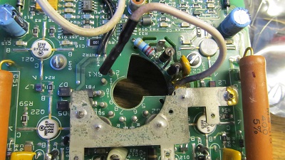

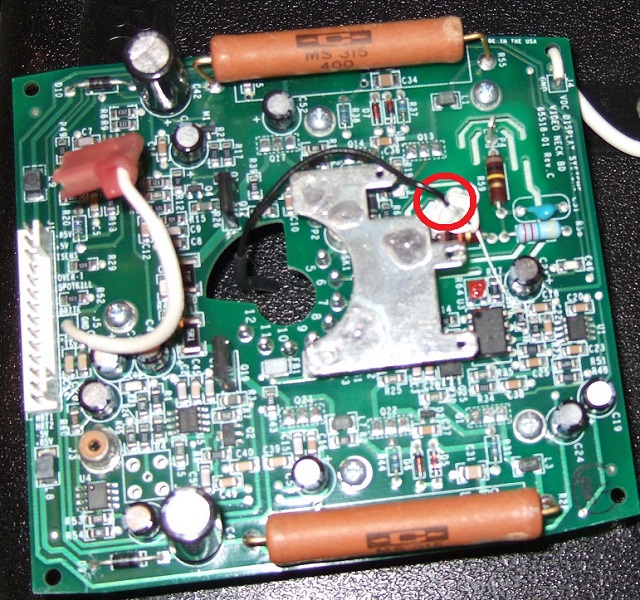

This is the old type neckboard where the G2 connection is comming from the PCB in the white wire, supposed to be connected to Pin2

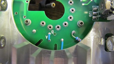

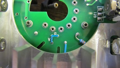

This is the backside of the new NB.The strap from a to b is connecting G2 from PCB to pin6 (LUG type G2 connection)

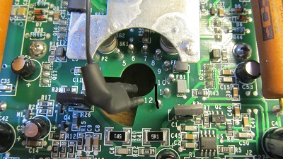

This is frontside of new NB. Black wire from ground to Pin 1 and 2 on LUG types.

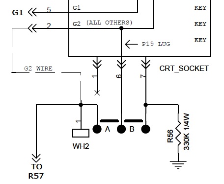

It's much easier:
- Remove the jumper at Position A
- Solder in the jumper at Position B
That's all I needed to make them work with LCP tubes...
Make sure that the G2 voltage is taken from the designated connection point near R57 (10K Resistor, black-brown-orange).
Regards,
barclay66

Another thing:
Nothing gets shorted when putting the jumper in the 'B' location. There it connects the tube's pin 6 together with pin 7 and ties them to ground via a 330k resistor.
The G2 line is left open and with the G2 wire (has to be added if it's not there) You connect G2 to pin 2 following the LCP pinout...
Regards,
barclay66

This makes sense ... In the "B" position the G2 output is the routed to the 330K resistor connected to ground and via WH2 wire to pin 2 and G2.
I should have consulted the schematic for the new NB. It is shown there Embarassed

Misread your picture with the jumper.
In "B" position , pin 6 & 7 are connected together and via 330k to gnd.
G" just routed via wire to pin 2..

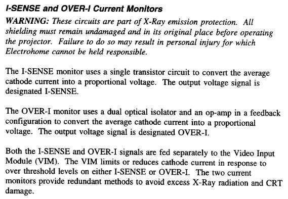

Unfortunately, the setting that is adjusted via R64 is not the spotkill part but the beam current limit. Maybe there's a document describing how to adjust that on the older style neck boards. The service manual mentions that this section is critical for safety but there's nothing to be found on its adjustment procedure. These potentiometers are ususally glued to a factory setting...

Would it be possible to measure the voltage @ +vf2 (and -vf2) and adjust with the new components to the same value (difference)?
Do you think it is the over-i sense that limits the performance. I would guess the spotkill cannot affect the performance..?
What is home theater without good sound?
barclay66
Joined: 27 Jun 2011
Posts: 1304
Posted: Thu Jul 23, 2015 5:31 pm    Post subject:
Using reference measurements could be a suitable way indeed. What could be used too is testing with different video input levels in order to see how the I-sense output on the neck boards behaves and when the over-I signal kicks in.
I'm quite convinced that the different beam current control circuit is responsible for the lower contrast and brightness level...
