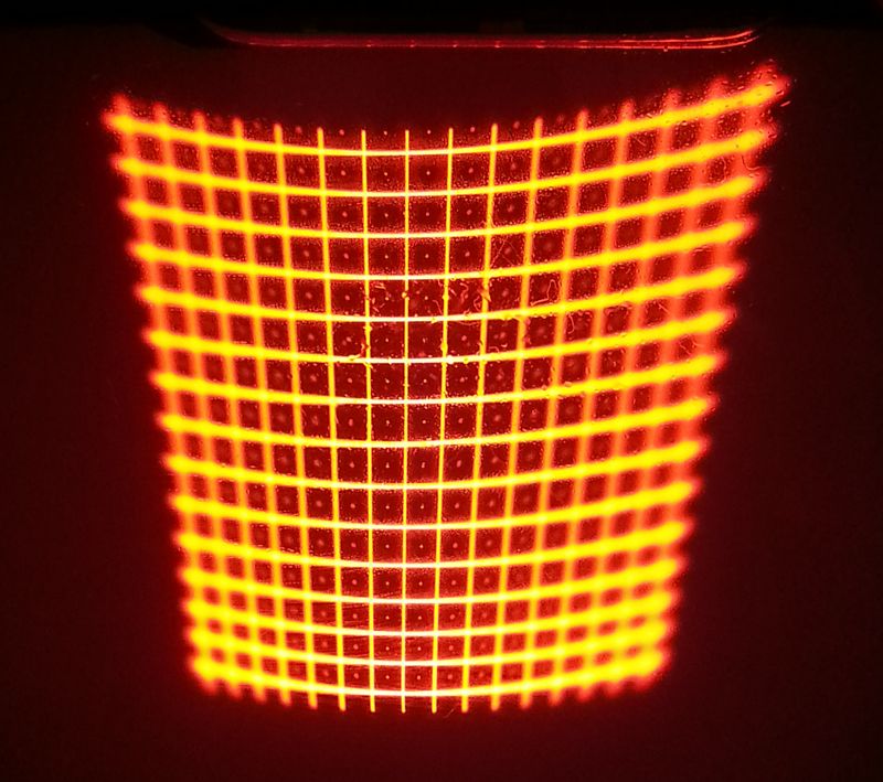

Hi can someone help me. I am having trouble focusing the tubes on my ECP 3500. Basically I can get the centre of the picture focused, but the edges are always blurry. I tried swapping the focus/bias board but it made no difference. It's the same on all three tubes. The photo is of the tube face, not the projected image, so it is not a lens issue.

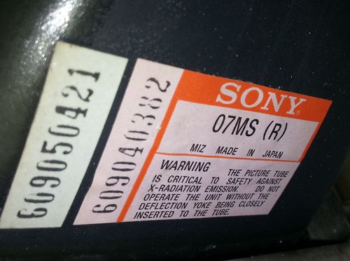

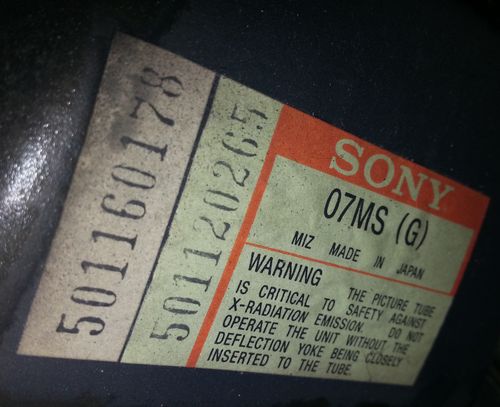

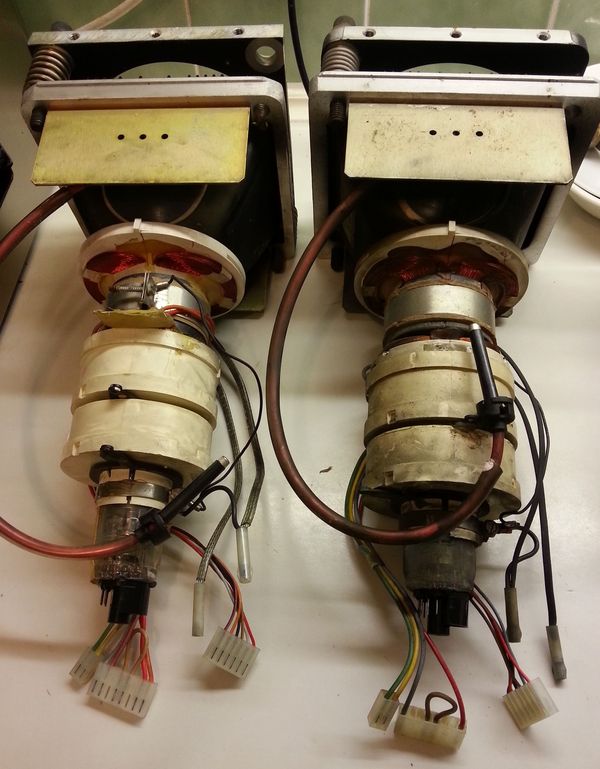

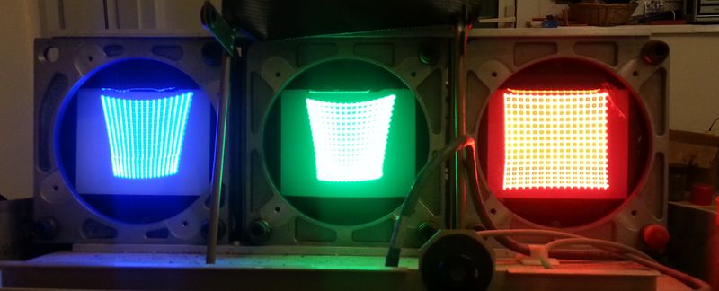

Bit of an update. I tried putting one of the old tubes (red) back in and it fixed the focus problem for that tube. You can also see that in addition to the focus problem there is a keystone problem with the two new tubes.
The old and the new tubes are both the same model 07MS (the photo of the rear of the tubes has the new on the left, old on the right). However I noticed a slight difference in the wiring configuration of the yokes. The new have a few extra wires on one of the connectors. Are they incompatible? Also the astigmatism magnets on the new tubes have not been set, but I wouldn't have thought they would cause this much distortion.

Hello
You have installed tubes from an ECP4xxx and the yokes are different. The correct yoke has two wires for H scan, not four. That would be the yoke on the right in your ecp2 pic. Put the right yokes on your better tubes and you might have it solved.

Guys
The ECP4xxx used two sets of H yoke windings as did the Marquees; on each yoke the windings run in series up to 33khz, then switch to parallel to get more current into the yokes; this enables uniform raster widths across the entire range. The ECP 3xxx ran one set of windings and saw the width pull in some above 45khz. The ECP3500 was rated to 60khz but width pulled in about 15% up there so it was not very useful at the top end.
