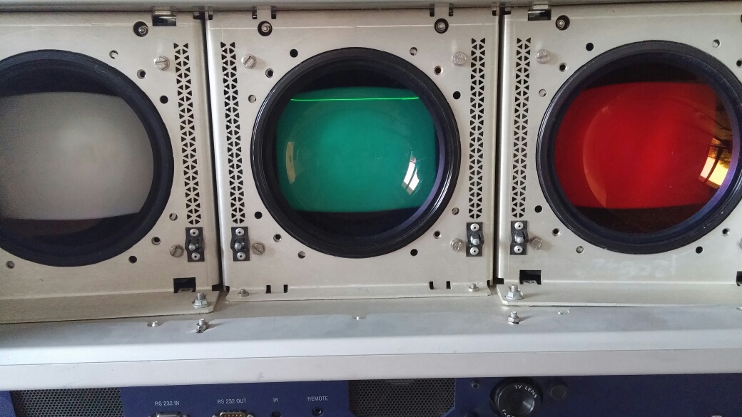

Hello Guys,
I have bought a Barco Cinemax (arrived today) with fresh new tubes and less than 3000 hours on the counter.
Unfortunately, it seems there is something really wrong with the unit, or this just me getting older.
There is a faint green line on the green tube (which is an Eisemann LUG Simulation grade). The green makes also a subtle cycling (very fast cycling) noise. It sounds like little electrical discharges.
Enough ?
No...
I'm not able to make it sync to anything in the house too. I can run through the menus but it is unable to display any external source. I have tried with my pc to port 4/5 and from a PS3 to HdFury with no results at all.

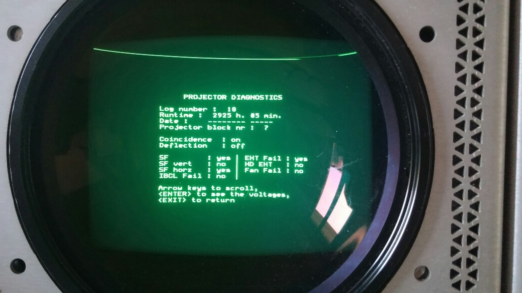

K-L-O
Joined: 04 Jun 2007
Posts: 54
Posted: Fri Jun 05, 2015 7:44 pm    Post subject:
A couple of pictures....
Here is the line.
 Filesize:  192.84 KB
 Viewed:  11881 Time(s)
K-L-O
Joined: 04 Jun 2007
Posts: 54
Posted: Fri Jun 05, 2015 7:49 pm    Post subject:

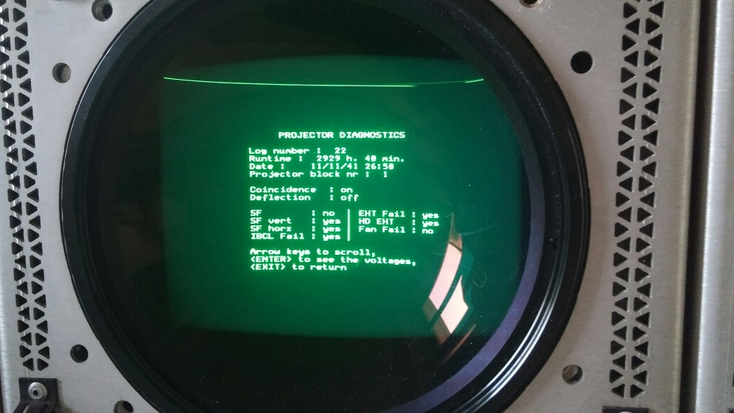

Log File
 Filesize:  132.09 KB
 Viewed:  11876 Time(s)
K-L-O
Joined: 04 Jun 2007
Posts: 54
Posted: Fri Jun 05, 2015 7:51 pm    Post subject:
After tube change
 Filesize:  139.83 KB
 Viewed:  11870 Time(s)

Posted: Sat Jun 06, 2015 1:59 am    Post subject:
Line problem solved.

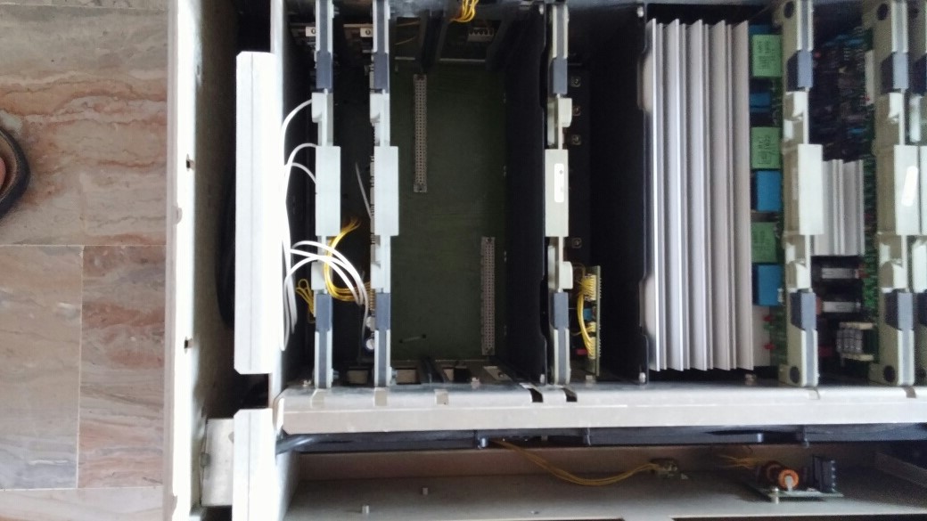

Posted: Sat Jun 06, 2015 5:21 pm    Post subject:
Thanks for the interest guys,
The HD Fury is working perfectly, tested on Bg1209s and 9500LC Ultra. This is a version 3, I would upgrade with something better, but need to know what is wrong and what is missing with this unit. It was annouced as perfect working Barco with new tubes, I expect it to work because I paid for a working unit not a unit to be fixed.

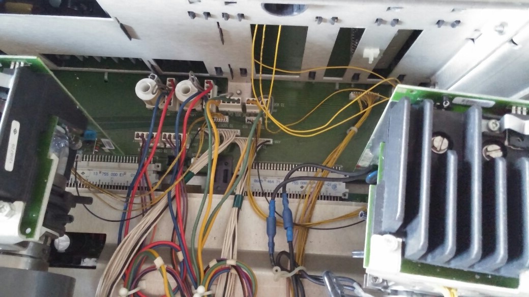

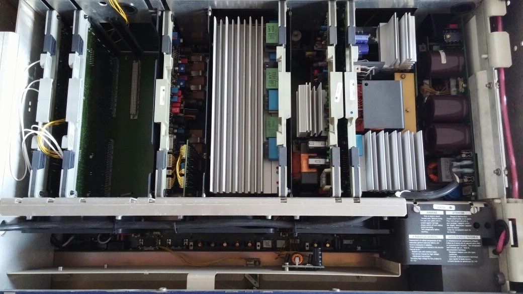

Here are some more pictures, maybe some one with a Cinemax may enlight if there is something missing. It seems extremely empty compared my 1209s and 1208s.
 Filesize:  179.93 KB
 Viewed:  11708 Time(s)
K-L-O
Joined: 04 Jun 2007
Posts: 54
Posted: Sat Jun 06, 2015 5:22 pm    Post subject:
Empty slots
 Filesize:  138.57 KB
 Viewed:  11706 Time(s)

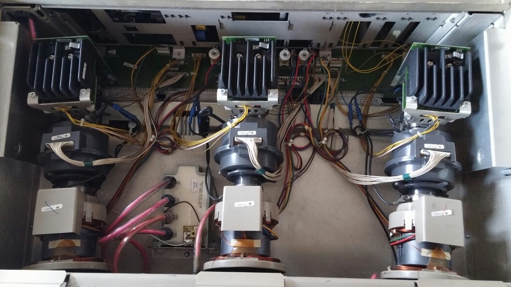

Tubes compartment
 Filesize:  182.22 KB
 Viewed:  11704 Time(s)

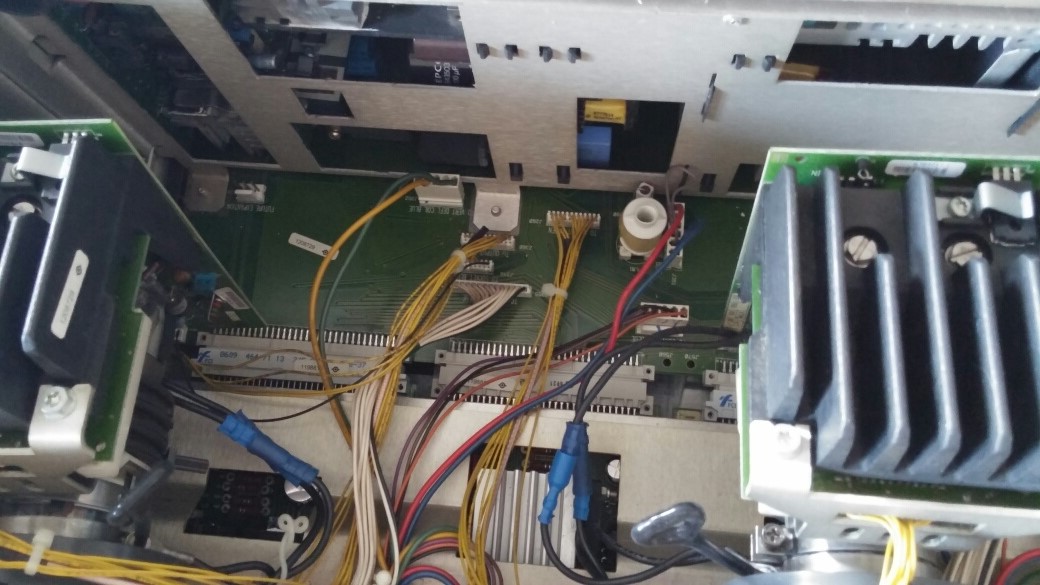

Yellow cables here and there...
 Filesize:  166.93 KB
 Viewed:  11702 Time(s)
K-L-O
Joined: 04 Jun 2007
Posts: 54
Posted: Sat Jun 06, 2015 5:28 pm    Post subject:
Yellow cables there Rolling Eyes
 Filesize:  154.92 KB
 Viewed:  11700 Time(s)

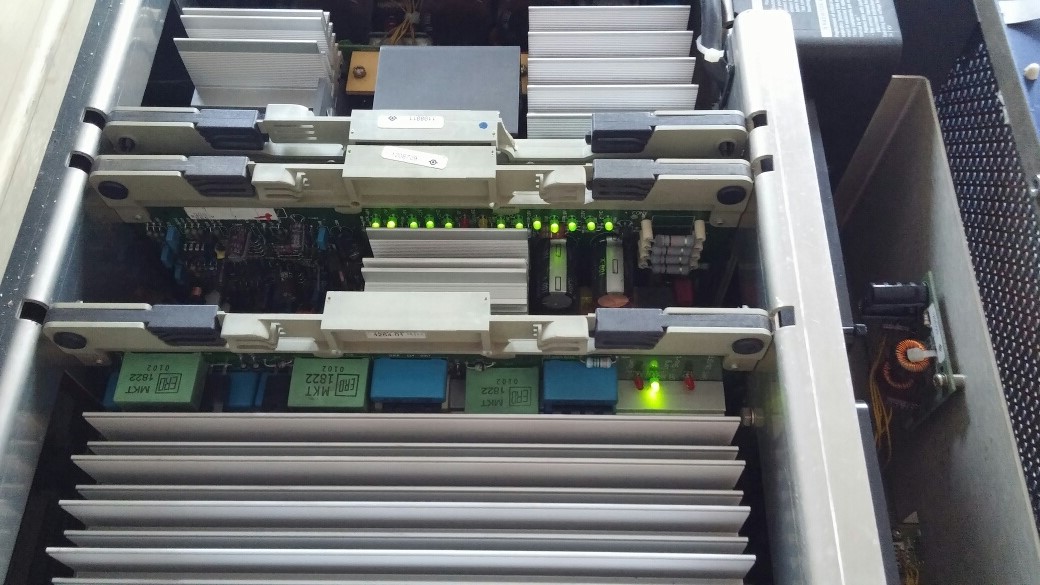

Posted: Sat Jun 06, 2015 5:30 pm    Post subject:
Diagnostics leds, unit on.
 Filesize:  169.5 KB
 Viewed:  11697 Time(s)
Posted: Sat Jun 06, 2015 6:27 pm    Post subject:
Since you have onscreen menus, your fault has nothing to do with anything that the error LEDs will show. Most likely an input signal or video board problem. I can test them for you if you want, and do repairs if required.

Posted: Sat Jun 06, 2015 7:54 pm    Post subject:
The two missing boards are LimoPro and input 3 card ( you was not trying to use port 3 do you, cause that would explain your lack of picture...). Not such a drama, it is even recomanded to remove them. Use a scaller or computer instead of that stone-age internal LiMoPro and port 3 slot should be use for a internal Moome card.
The other thing missing is the fan speed-regulator on the rear fans ( R763706 ). Pull the front tray out and post a picture of it, please. A second fan speed-regulator should be there too, for the front fans.
The mains filter is not behind the rear fans neither, but i see it was moved to the left side by the previous owner.
Don't worry about the yellow cables, they look allright. Those four wires from the internal remote should go trough that black plastic ring. Else they could be striped from opening each time the moduled lid. Chassis edges are sharp.
I'm sure you should be able to get a picture out of that baby. Could be something silly, like a poor contact somewhere from during transportation. Pull out and reinsert all the cards and connectors one by one. Sometimes it helps...
