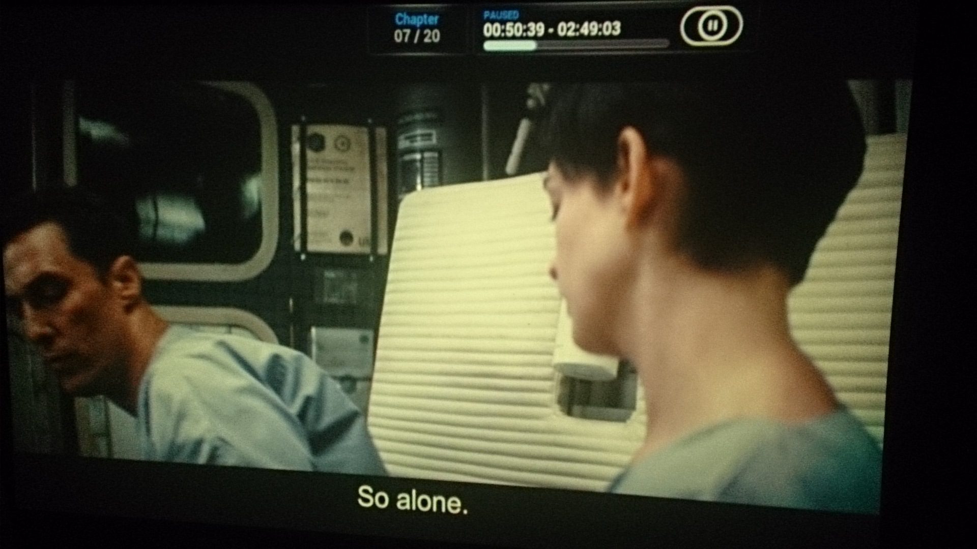

Posted: Wed Jun 03, 2015 12:54 pm    Post subject: Spot burn, delamination or dust?
I have discovered two black dots on the green tube. They only manifest themselves during white scenes but being close to the center, they are noticeable.
I was under the impression that the focus is shallow and on the phosphor layer but would something on the outside of the glass show up fairly in focus?
Get new tube?

Melifluonze wrote:
Posted: Wed Jun 03, 2015 8:09 pm    Post subject:
If the dot does not move with raster shift, then I'd guess it's the tube.
Posted: Thu Jun 04, 2015 12:39 am    Post subject:
Or on the lens
winny
Joined: 09 Oct 2013
Posts: 403
Posted: Thu Jun 04, 2015 8:24 am    Post subject:
Wouldn't the lens be too far out of focus plane for that to be projected as such small dots and fairly sharp?
Dust/spec on the front of the tube ?
Melifluonze wrote:
Posted: Thu Jun 04, 2015 9:03 am    Post subject:
Possibly, youd have to shine a torch in there and see if its on the phosphor or the glass
jbmeyer13
Joined: 03 Dec 2010
Posts: 1135
Posted: Thu Jun 04, 2015 3:53 pm    Post subject:
That's either something on the inside of the C-element, phosphor delamination or a defect in the tube glass itself. I bought a brand new tube last year which exhibited the same issue and after draining the glycol, cleaning the c-element and tube glass I discovered under close examination that it was actually a defect in the glass. Steve Flynn told me that he used to send back a fair number of tubes to VDC after QC'ing them and finding these types of issues.
I've seen a spot burn and it doesn't look like that.
Posted: Thu Jun 04, 2015 5:15 pm    Post subject:
Guys
Looks like spot burn, and I would look into that tube at power-off and see if spot-kill has problems. I would not replace the tube until the problem that damaged it gets corrected.

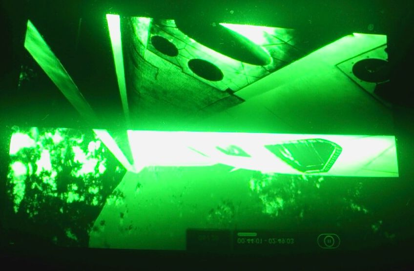

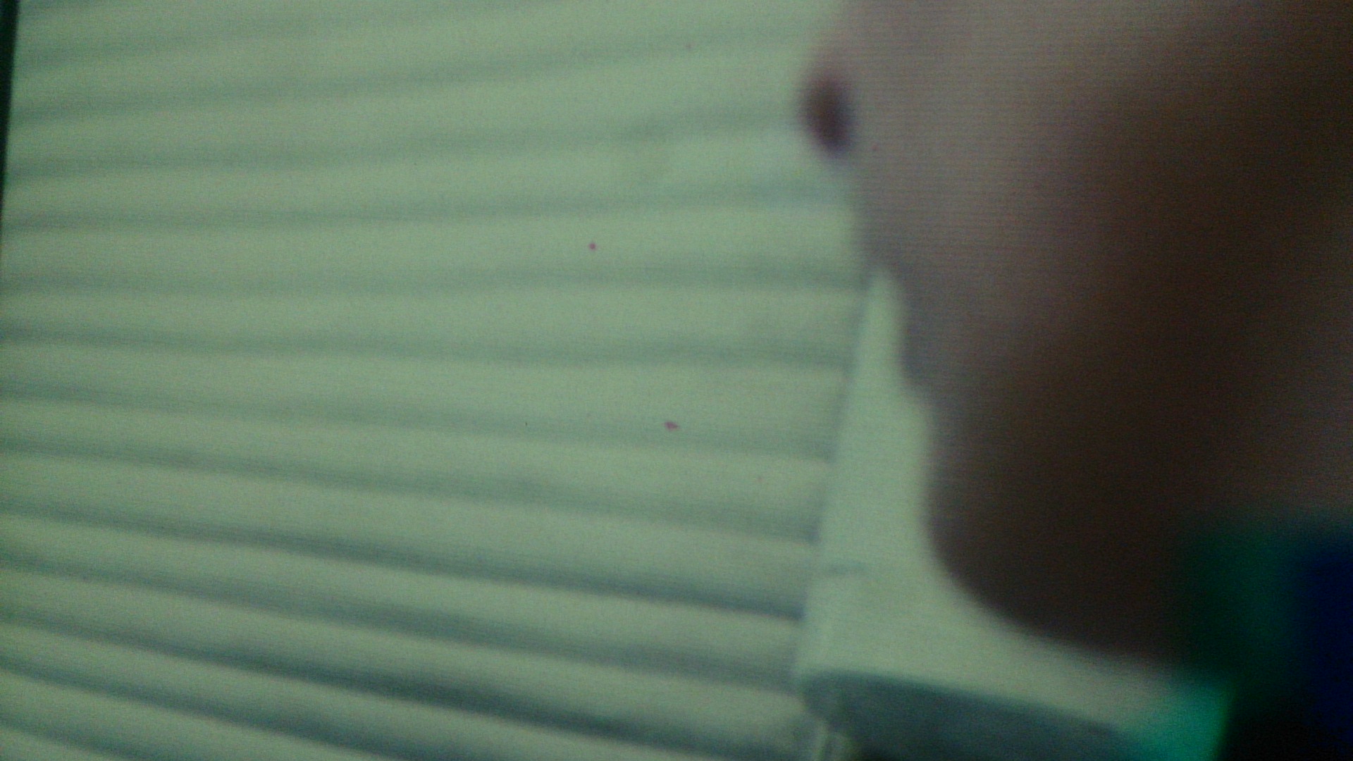

As for spot kill, it goes from full brightness to black before any collapse/shrinking of the image area. Just the afterglow visible. My eyes did start to clip/distort though. Do I need to check more thoroughly that that, like film it with very open shutter and check frame by frame?
Took the lens off and it certanly looks like the phosphor. Sad
Bloody difficult to take a photo of without a full manual camera. Refresh rate of projector didn't match or wasn't too out of sync to give me a complete picture and the active scan lines being way brighter than the rest confused the camera.

Melifluonze wrote:
Posted: Wed Jun 10, 2015 8:30 pm    Post subject:
I disagree with jb, I've seen many tubes with phosphor flaws that look exactly like your original images on the top.. including spot burns that I've caused myself.
Well it's either the phosphor or the tube glass. If it wasn't there initially and then suddenly appeared it's the phosphor. In either scenario you have to be willing to live with the defect or replace the tube.
I have a green tube (originall panny) that was in perfect shape with minimal hours that all of the sudden started displaying a wonky fireworks show when powering off. In that case I was pretty sure that it's tube contamination and replaced it. These are unfortunate occurences endemic to CRT.
Posted: Wed Jun 10, 2015 11:32 pm    Post subject:
Yes, exactly! I've got two new (old stock) blues here that arc when pushed with contrast over 80. It's an internal arcing right at the HV lead, but inside the tube. Completely useless, which is a shame.
